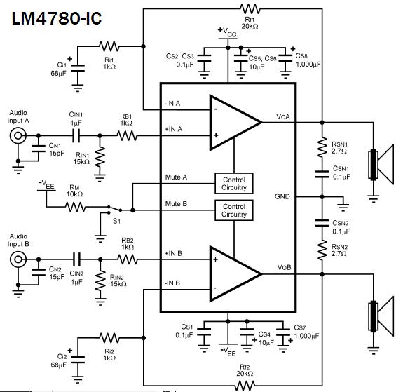

I'm thinking i might go with tcmtech's 120w (mono) 60w(stereo).
I would like to use this as stereo and i believe the attached image is the schematic i should use?
Aswell does anyone know the percentage distortion with stereo use. What would be the best voltage you think?
Also is this a strong chip, not going to be damaged easily because its quite an expensive ic +$20
thank-you
just quickly went over circuit again...their doesnt seem to be volume control??? how could one be added in without destroying the ic?

Just read the rest of the data sheet it tells you everything. you just have to look for it.
Look at the datasheet for all the details. Figure 5 has additional parts to protect it from oscillation.
Use a 10k log volume control at the input. The datasheet shows it.
He is one more I have a schematic for. (my tech info archive is is over 14 gig)
This one is still available at digikey, I checked this time! its about $13
It should meet all of your design specs needs from small to 300+ watts per channel. :)
