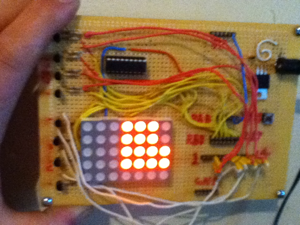

Questions on upgrading my Project**UPDATE**
Thanks to the directions of ljcox I have been able to now see how I am going to tackle my project here.
As discussed earlier in this thread, I had some questions about how to drive my 15 cathode columns and sink my 7 anode rows for my 15x7 moving display. My original source(talkingelectronics.com) has things different than the parts I have. They used leds and I wanted to use the mis-ordered 5x7 display modules I have.
Well I'm working on this slowly and surely as my brain will allow...lol.
This may be hard to understand but links to my sources and pics and video and asm's will hope to help you.
Like I said its gonna take some time for me to get the whole picture, but, i'm working on it and starting with 4x4 first.
Thanks and comments and questions are invited.

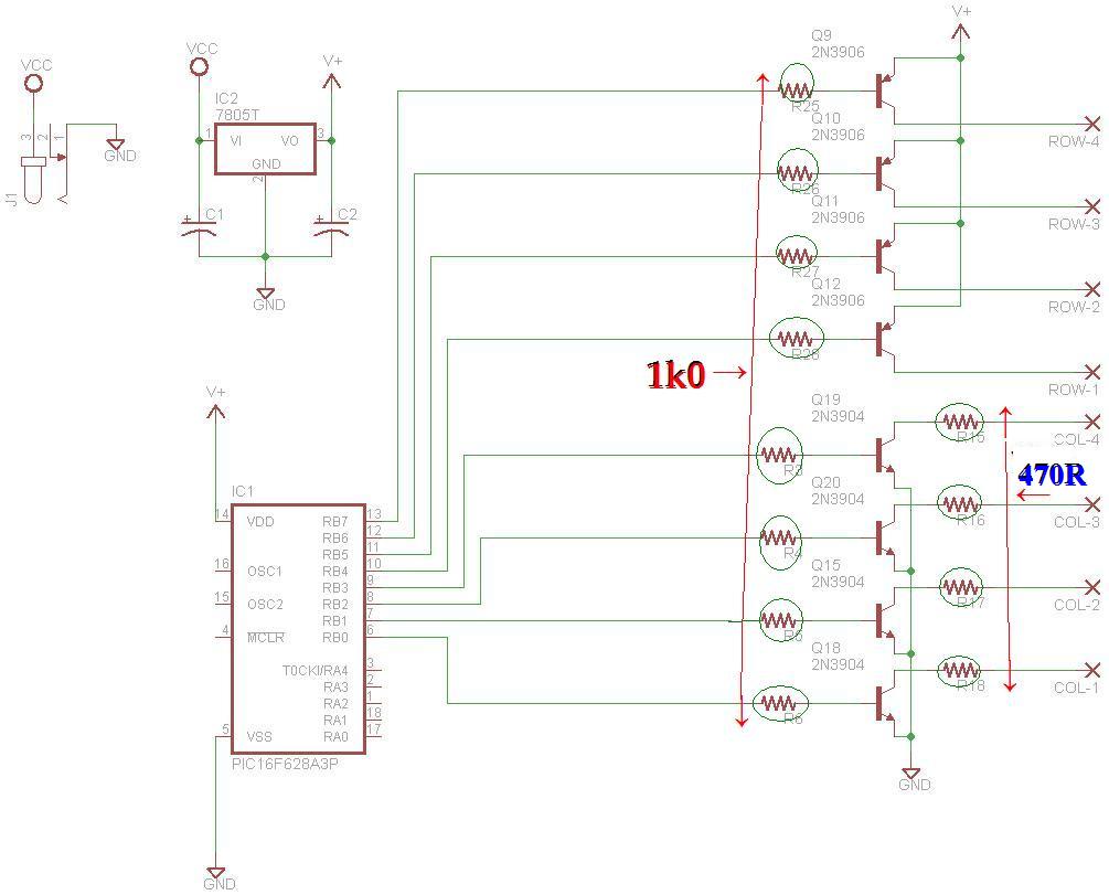

Question to the "UPDATE"
I noticed that there is still some current running through the rows and maybe the columns so I increased the inline resistors from 1K0 to 2K0 and still see real faint flicker when leds are not supposed to be on.
Anyone know what may be a solution to this? You may have to watch ((((MY VIDEO)))) from post #25 to understand.
PS. attachment below of the schematic below.
Try adding a respective resistor (say 10 x the base resistor value) between base and emitter of each transistor, to ensure turn-off.
That should not be necessary since the PIC outputs switch between V+ & Gnd.
I study your circuit further & post later.
This is how I would do it.
Remove resistors R15~18.
Insert resistors in series with the emitters as in the diagram.
Change the base resistors to 3k3.
This arrangement not only saves on the number of resistors, but it provides a reverse bias to the transistors that are supposed to be off.
EDIT.
I just did what I should have done intitially - calculate the voltages & currents.
I have replaced the previous diagram with a new one & added the drawing that I did to do the calculations. (Drawn for the situation during one scan period)
However, I really think your problem is in the software. I think there may be an overlap period where the next transistor is turned on (then a short delay) before the previous is turned off.
But try the hardware mod first as it saves on resistors anyway.
If it proves to be in the software, I have a suggestion as to how you can fix it.

I think your calculations are true. I remember something about pnp and npn switches drop 0.7 volts when turned on.
I'm gonna try to get this into the proto-board and see if it clears up the problem. Then next will be to proof read the software.
Thank you Len and Thank you alec_t for the responses.
Tom,
It occurred to me, while having lunch, that your problem could be due to the transistor storage time since you are over driving the transistors.
Yes, the base/emitter voltage of bipolar transistors is in the region of 0.6 ~ 0.9 Volt depending upon the collector current.
The collector current in bipolar transistors is determined by the charge in the base/emitter region. This is a function of the base/emitter voltage. Thus the collector current is an exponential function of the base/emitter voltage.
When the transistor goes into saturation, there is an excess of charge in the base/emitter region.
This means that when the voltage driving the base current is switched to zero, the collector current does not fall to zero immediately because the base/emitter charge maintains the collector current until it decays to the point where the collector current is no longer sustained.
I have attached the results of the simulation I did of your circuit. I only included the NPN side since the PNP side will be similar. The simulation shows that the storage time is about 2 us.
This time seems too short to be a problem, but perhaps not. Of course, any software delays will add to this time.
In my next post, I'll attach the simulation of the circuit modified as I suggested.
Here is the simulation of the modified circuit.
Note that the storage time is now about 0.75 μs because of the reverse bias across the base/emitter junction when the driving voltage V2 goes to zero and the because there is less charge then the base emitter region. In the previous post, the base/emitter voltage was 0.83 V whereas it is 0.75 V in this case, compare the third attachment in each post.
Note that the base current is about the same as before (-0.7 mA) because the base resistor is 3.3 times greater.
The base voltage is approximately 2.4 V while the transistor is on, so the current that is causing the base charge to decay is -2.4/3.3 = -0.7 mA. (it is negative since the current is coming out of the base).
Here is another option.
It has 2 advantages
The LEDs are reverse biassed when off.
The LED that is on has the sum of the collector & base currents (ie. the emitter current) through it.
However, you need to change the .asm in order to invert the PIC outputs since RB3:0 must now be Active Low & RB7:4 must be Active High.
Note that the storage time is about 0.2μs.
