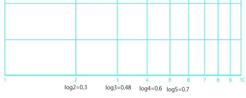

Another problem about the semi-log plot that has been confusing me is:
Why is the distance between 1 and 2, or between 10 and 20, or between 100 and 200 etc largest? For example, the following plot shows that the distances between points are not the same, what is the advantage?
I noticed that log2 is located at about 3/10 of one unit, log3 is about 1/2 of one unit etc, what profit can we get by doing this?

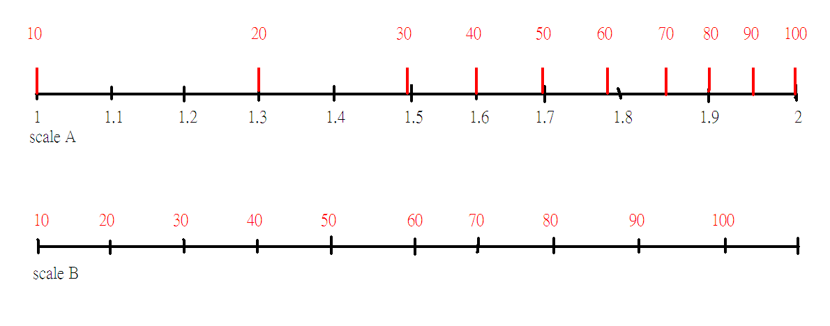

My question is: Why do we use the scale A instead of the scale B shown below? What's the advantage scale A is over scale B?
I mean if the X-axis indicates frequency, we can make not only 1Hz, 10Hz, 100Hz, 1000Hz ... equally spaced, but also make 1Hz, 2Hz, 3Hz ... 10Hz, 20Hz, 30Hz ... 100Hz ... equally spaced. Why don't we adopt this simpler scheme?
Hi again,
I am replying with two posts for the separate questions to keep things a little more clear hopefully.
That's just how the log function works, it compresses some ranges and allows other ranges to be wider. It helps us because of the way some things respond in nature, or how they relate to reality.
For example, the 'difference' between 1 and 2 is the same as the 'difference' between 9 and 10, yet these two ranges do not appear to take up the same spacial span. Subtracting, 2-1=1, and 10-9=1, so they 'should' be the same. However, if we look at the ratios we see a whole different story:
2/1=2.00
10/9=1.11
Now we see something different, jumping from 1 to 2 we have to jump by 100 percent, while jumping from 9 to 10 we only have to jump by 11 percent. That's quite a 'difference' now, and now the jump from 9 to 10 does not look as important as the jump from 1 to 2 anymore.
This is actually quite significant too, because often our devices do not change in response that much for incremental changes that are small relative to the initial value (like 9 to 10) while the response change can be much more significant for small changes that are large relative to the initial value (like 1 to 2).
A good example of this is the open loop frequency response of an op amp. If we look at the data sheet for an LM358, we see a graph of voltage gain vs frequency. The frequency points on the x axis of the graph shown are:
1,10,100,1k,10k,100k,1M,10M
This means that the change between 9Hz and 10Hz has about the same significance to a design as the change from 90 to 100, and also about the same as the change from 900 to 1000, and 9k to 10k, etc.
So in the end, the change from 9Hz to 10Hz has about the same significance as the change from 900kHz to 1000kHz, even though they are very different frequencies and between 9 and 10 we only have 1Hz while between 900kHz and 1000kHz we have 100kHz, which is a hundred thousand times greater.
Thank you!
This is one of those cases where you should sit down, roll up your sleeves, and dont be afraid to get your hands dirty. Sit down and try to graph the plot of voltage gain vs frequency for the LM358 and see what happens.
Also, there are two ways of interpreting your question. The first way means we keep the same spacing for every frequency, the second way means we keep the same spacing only between one such group like from 1 to 10 or from 10 to 100, but still allow variable spacing. So we would see 1,2,3,4,5...10 for the first group, and 10,20,30,40,50..100 for the second group.
For the first interpretation we would have far too many points to plot.
For the second we would see a graph which is very wavy rather than have a straight line, because things in nature do not usually follow that kind of rule. So we'd see a graph that had many droops in it or many bumps in it, when doing it the other way we'd see a nice smooth curve even though we use the log scale.
If you sit down and try to graph a curve like that of the op amp frequency response you quickly get a feel for this. That's what i was trying to get at in my other previous post about two posts back. Trying things out ie testing the ideas that you have can get you going a long way. If you think something is better another way, then try it and see what happens. Once in a while it may turn out that it makes it better for you yourself alone and so you may still find it useful even if others dont like it, but sometimes it could turn out that it could make it better for others too.
Your apparent interesting in these subjects tells me that you are one of the few who are willing to take this last step and find things out by experiment. Also, as you learn to design your own experiments, you get better and better at this so you progress faster and faster.
