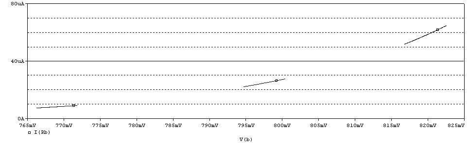

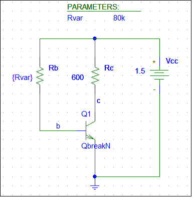

Here's what I did:
I use 3 different Vccs: Vcc1=1.5V, Vcc2=3V and Vcc3=6V.
For each Vcc, I plot the Ib-Vbe characteristics by altering Rb from 80k to 100k while keeping Rc not changed.
The result is as shown in the 2nd figure. The horizontal axis is Vbe and the vertical axis is Ib. The left straight line is for Vcc=1.5V, the middle for Vcc=3 and the right for Vcc=6.
For each Vcc, dIb/dVbe is a constant, and is bigger when Vcc is bigger which seems to be showing that at larger Vcc, the change in base current per unit change in Vbe is larger. Doesn't that mean at larger Vcc, the bsae (or collector) current is more sensitive to Vbe?

Here is the context...
You are given a task to complete, you have to design the bias circuit for a transistor that has a DC current gain of 10, and you have to bias the output to 5 volts, and the circuit should not draw more than about 100ma. You can however choose any Vcc you want from 5v up to 25v, any base resistor, and any collector resistor, but you have to design it such that the bias point change is minimal with any change in Vbe (from temperature or change of physical transistor). What Vcc, what Rb, and what Rc do you use in order to keep the bias point as stable as possible with change in Vbe? The transistor model you are allowed to use is the current controlled current source where the input of the current source is in series with a small battery which represents Vbe and is around 0.5v. Since the gain is 10, that means if you input 1ma into the 'base' you always get 10ma through the collector, just for example.
To make this even simpler though, we are given only two choices:
1. Vcc=10.5v, Rb=2000 ohms, Rc=110 ohms
2. Vcc=20.5v, Rb=4000 ohms, Rc=310 ohms
Which of these two circuits keeps the bias point more constant when Vbe increases by 10 percent, #1 or #2 ?
Note that both circuits provide a 5.000v output with Vbe=0.5 volts.
Also note that with Vbe=0.5v that means in #1 we have 10v across Rb, and in #2 we have 20v across Rb.
Thank you very much, Ratch.
Why is the emitter current negative? It should be almost the same as the collector current.
In PSpice, the emitter current reference direction is into the emitter terminal, so there's a negative sign there.
I believe this is also the case in LTspice.
Hi again,
In addition to post #18 here is another example.
Same voltages, 10.5v and 20.5v, but this time we hold the base resistor Rb=2000 ohms and collector resistor to 110 ohms, and we want the output biased to approximately 1/2 of Vcc.
With Vcc=10.5v and Vbe=0.5v again, the output is biased to 5v, and when we change Vbe to 0.55v the output goes up by 27.5mv.
With Vcc=20.5v and Vbe=0.5v the output is biased to 9.5v, and when we change Vbe to 0.55v the output again goes up by 27.5mv.
So the fractional percentage change with Vcc=10.5v is 0.0275/5 and with Vcc=20.5v it is 0.0275/9.5. The change with higher Vcc again is less, meaning the bias point (with change of Vbe) is more stable with higher Vcc.
