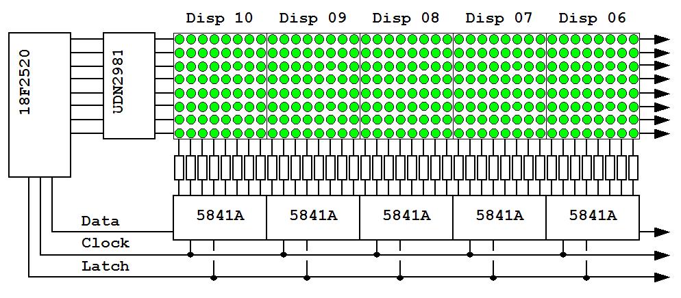

Hi Guys,
I've acquired some 8x8 matrix LED displays and would like to do something similar... Do you think the scheme below will work?
I figured I'd scan each row of 40 LEDs one at a time for decent brightness (12.5% duty cycle on any individual LED) and the UDN5841A output pins would only sink 20-ma for a single lighted LED in a column during any one of the 8 row scans...
TIA, Mike
I figured I'd scan each row one at a time for decent brightness (12.5% duty cycle) and the '595 output pins would only need to sink 20-ma for a single LED at-a-time...
Hi Mike,
If only a single LED was addressed on a row and column, with a 12.5% duty cycle and 20mA of current, then its average current is only 2.5mA and it will be very dim.
If more than 1 LED is lighted on a column, then they must share the available 20mA and would be extremely dim. :cry:
Hi 'guru,
Thanks for the input...
They're low current LEDs so I'm hoping I'll get brightness levels similar to those on the Agilent low current 7-segment displays used in my Charlieplexing experiments... In those experiments I found anything above a 10% duty cycle provided very decent brightness levels...
I'm not lighting multiple LEDs per column, rather, I'm lighting up to 40 LEDs per row while 'scanning' one row at-a-time... I suspect the 500-ma source current spec' for the '2981 is a little light so I may substitute discrete higher current P-channel MOSFETs...
Regards, Mike
