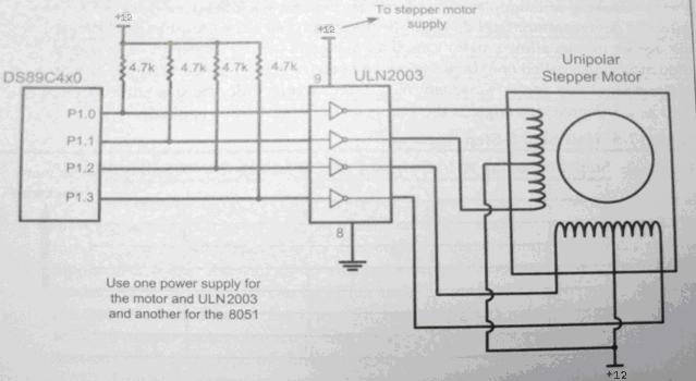

Hello. I am interfacing a 12V stepper motor to my 5V microcontroller. I have this image from a textbook of mine, which is attached. As you can see, it says to use one power supply for the ULN2003 and motor and another for the 8051. My question is exactly what does this mean?
I am in the process of building a 120VAC/DC converter using the standard transformer, bridge rectifier, and a smoothing capacitor. The output of the capacitor will be approximately 12V with VA rating of the xfmr large enough to supply current to both the motor and control circuitry. I then wanted to use a switching regulator buck converter to convert the +12V to +5V with 300mA Iload capability to power my 8051.
Can I use this 1 transformer, 2 voltage level design to power both my 8051 and my motor? Or do they need to be totally isolated, meaning I need 2 transformers with the 12V and 5V turns ratios?

The ideal solution is two power supplies; 5V one for the uC, 12V for the stepper, with opto-isolation for the logic drive.
Second best is two power supplies, common ground connection, without opto-isolation.
Third best is one 12V power supply, with a linear regulator to create the 5V, common ground.
Preventing inductive spikes from the stepper getting into and interfering with the uC operation has generated hundreds of posts on these forums. If you start with option 3, you will learn more than you ever wanted to know about common grounds, single-point grounds, ground-loops, bypassing, common-mode noise, shielding, bypassing, etc...
Okay, that's what I was afraid of. So, my single transformer idea is out. Should I now proceed to buy 2 transformers (probably of equal turns ratios, lets says 120Vrms to 15Vrms, use 2 diode bridges and capacitors. Then for the 12V motor supply, use a simple linear regulator to keep it at 12V. And for the microcontroller, use the aforementioned buck converter to make it down to 5V? Thanks
You will probably need a lot more power at 12 V than at 5 V, so you will want totally different transformers for the two supplies, as both the turns ratios and powers will be different.

Okay thanks. So I'll buy 2 different transformers. Could I get your inputs on which transformers any of you have used previously?
My idea is that I'll input 120Vrms to both xfmrs. Accounting for approximately 1.4V drop across the bridge rectifier, then another 1.5V drop for a linear regulator, for the 12V I should buy a 12+1.4+1.5=14.9 + 10% ripple voltage for approximately 16.5V???
Same goes for the 5V supply, so a 9.5V output xfmr???
If my 12V supply is only going to supply a single stepper motor needing less than 1 amp, does it even need a linear regulator??? If so, would say a 12V 1A linear regulator be ideal?

Dont overlook something as simple as a 5V regulated wall-wart for the uC supply. They usually only need 50 to 200mA. I'm playing with a TI MSP430 right now that can do a lot of DSP-like computing on ~2mA.
