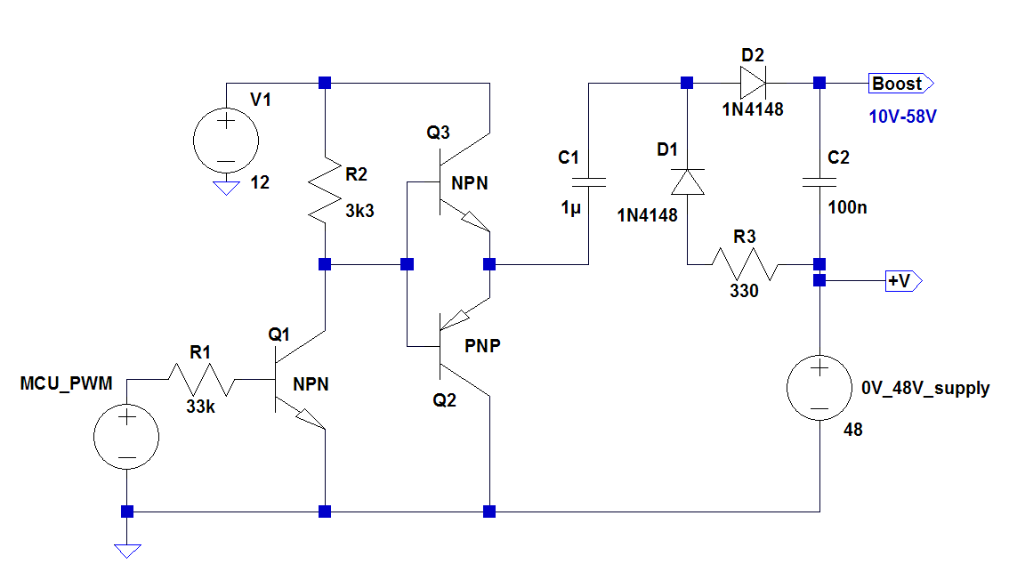

If you are going for NFETs on the high-side, here's a simple charge-pump boost supply for the gate drivers, using the PWM output of your MCU as an input :

Thanks Alec. That circuit looks like it will be very handy. If I went with the UCC21520 driver IC for example, would I simply connect the "Boost" output in your circuit to VDDA (pin 16) on the IC and omit the CBOOT cap as shown in figure 34 on page 25?
That should work.
