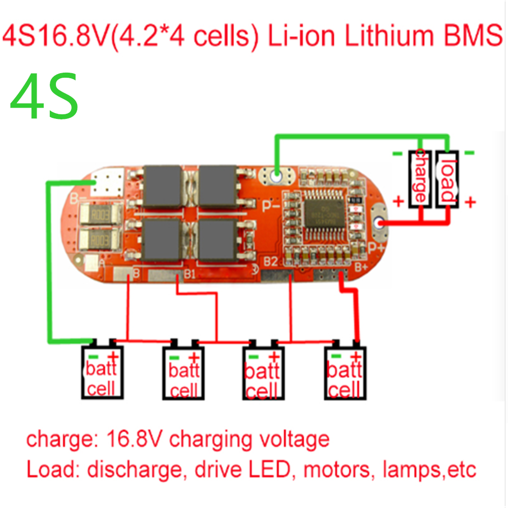

Hello,
I ordered bms from the bottom link. It is working ok with 5 batteries but i cannot get it to work with 4 batteries. If you look at the pictures, 3S, 4S and 5S look completely the same, same elements on same places. I ordered both 4S and 5S version and like i said, i cannot find a single difference between them so i dont know if they are identical and dont even know which one is 4S and which one is 5S. Is it possible that it is basicly only 1 version of BMS, but that it works with either 3, 4 or 5 batteries ? Anyway when i connect it like its on picture attached, i get 1.5V from the bms, instead of 16.6V.

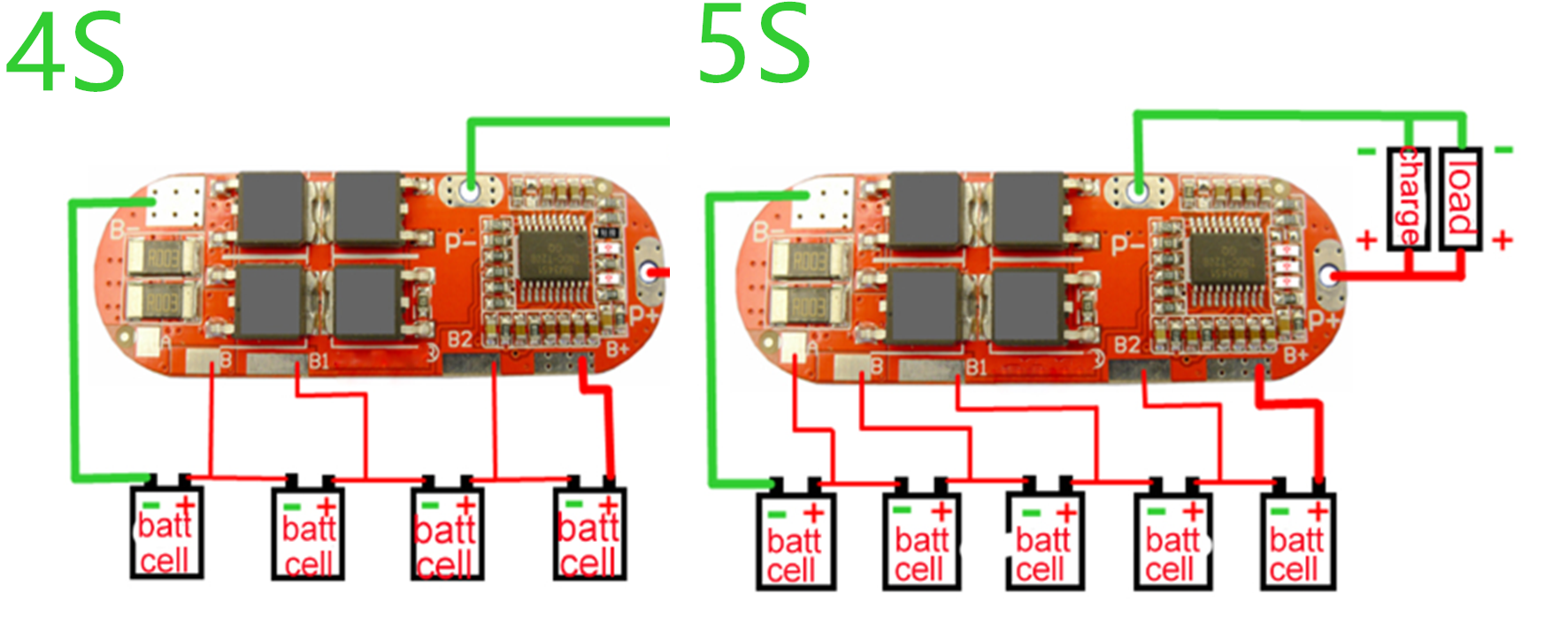

Hmm i would still like your input but i think i answered my question. 4S and 5S look almost the same but there are some tiny changes. I included image in attachment for you to see and also to maybe help someone in the future. Whats also funny is that my 5s that i ordered looks different then the one in an image. Some resistors or what are those tiny elements are not on the same places.

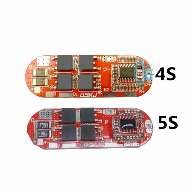

An image from another page. It would appear that all 3 of my modules are indeed 5S and that they sent me the wrong modules. Because all 3 of them are identical and i just rechecked, i indeed ordered 1 4S. So again, is it possible 3S, 4S and 5S are 3 identical boards ? Or do they have to be somehow different ?
Yes, quite probably the same boards, and you add links, or resistors, or whatever to configure the number of batteries - obviously THEY should do that, according to which board you order.
Read the number off the chip, and download the datasheet for it, that should make it clear.

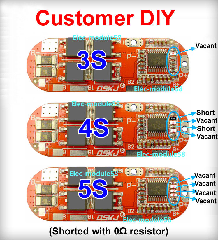

There is no number on the board, cant read what it says on the chips and doubt it would help me, i am not an expert. I will just keep those boards for 5S battery packs and i ordered 4S and will wait until it arrives. I also found another picture of difference between 3S, 4S and 5S.
The board number (if it had one, wouldn't mean anything - but with the number off the chip we could check the datasheet, try using a magnifier and a bright light, at different angles - you can usually make it out if you get the light just right.
Since they are cheap Chinese no-name-brand then nobody knows which one is which. I guess it would cost too much more to mark them.
Just wanted to say that i got my 4S board today and it is indeed working and i was right, its different than 5S board :))
