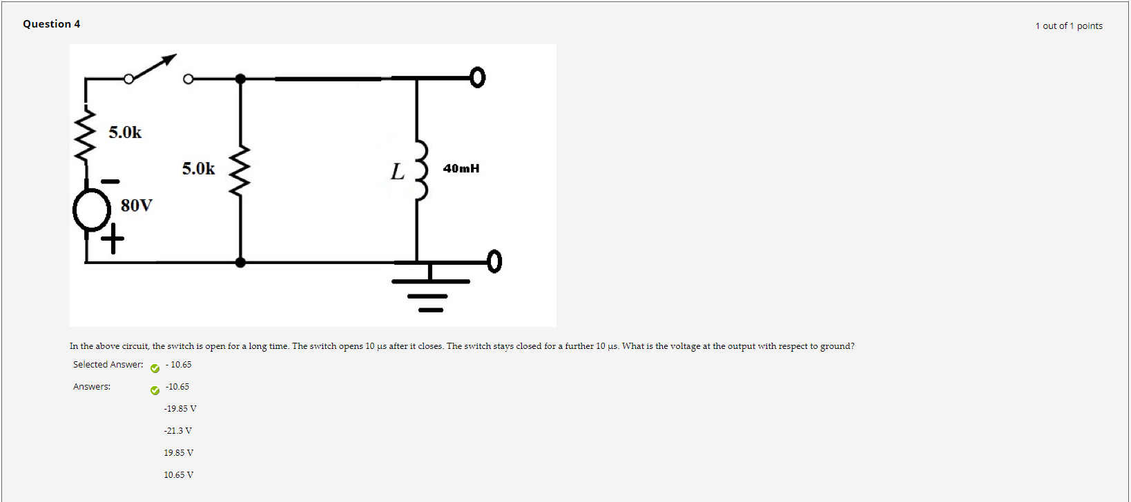

Hey everyone. I am writing a review for a test, and am having some trouble figuring out how I arrived at my solution (other than it was closest to the answer I got @11.79V. Hoping some one can help me out here.

I think I answered this. I went with the answer that was closest to what I did get. But, I am assuming that I should have gotten one of the answers listed.
this cannot be answered since they are missing a time variable in the states of the switch.
ie:
long open ---- 10us closed ---- UNKNOWN OPEN --- 10us closed then read.
0v ---- 10us ChargeV -- UNKNOWN DISCHARGE -- +10us ChargeV.
we cannot measure because we need to know how much it was discharged during the unknown open time period
You'd like to think so - and if you didn't, then you'd be marked wrong. However, for many decades (long before Internet) there have been questions out there that are completely and utterly wrong, and NONE of the answers have been correct.
Unfortunately, very often the questions are 'set' by someone with no electronics knowledge at all (for some reason English teachers were a common choice?) - and they simply get hold of old questions, complete with the answer sheets, and 'mix and match' the questions to create a 'new' exam paper.
In this way the faulty questions get perpetuated, and the Internet has only made this worse.

LOL. I love the story. Fantastic, and what I am getting here is that I may not have had the incorrect answer, just that the question is one of those questions that should not make its way onto an exam prep. (At least that is what I am choosing to take from that). Oh, also that your boss was a great guy, and you got a 25" TV as a prize?! :) I emailed the prof for this, and said that we did not cover any of this in the course material, so did not understand why it would be included in the exam prep.

I still don't know what the question is or how long the switch is closed.
