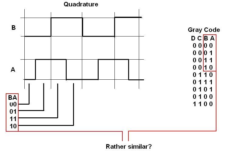

I suggest that "quadrature" is a subset of Gray Code.
Two bits, modulo 4
Please see my attachment.
Ok! I concede!! But just don't use a gray wheel decoder or it will just count up and down repeatedly!!!
That is a fair comment.
I guess that Gray codes give an absolute position, whereas the Quad code gives a relative position and is often used in conjunction with an index pulse to define a fixed position.
The only place where I have seen Gray codes used was in a remote display for a tank* level measurement system.
* A BIG oil storage tank.
If I remember correctly it had a float on the end of a steel wire.
As the level went up/down, the steel wire turned around a drum which drove allsorts of gears and numbers for a local display, and a GrayCode disc for the remote display.
Gray wheel decoder is just direction and count pulse just like Quadrature. Not up and down, rather up OR down, Or CW or CCW. Or in the case of stepper motors Step in/out from Direction and step. It is a reversible process used everywhere , even wind direction and anenometers.
