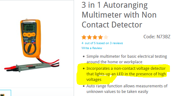

There are a variety of DMMs on the market that include non-contact voltage sensors. Maybe that's what you got, but it's from a brain-damaged manufacturer that doesn't know how to document its product.
I found this:
The flickering LED at the top of the meter is a non-contact voltage detector (NCV).
When you place the top of the meter near live mains cabling the LED lights (or flickers). It basically detects AC provided the frequency isn't excessively high. It's similar to those little pocket/pen devices.
Note the LED will flicker even when the multimeter is switched to off. Don't store the meter near mains cables on your desk otherwise it could flatten the battery.
And a few other references that say the same. Why it would not be documented in the manual I have no clue?
The quote was taken from here.
Ron

I presume it's just the same as the mains detect 'pens' you can buy?.

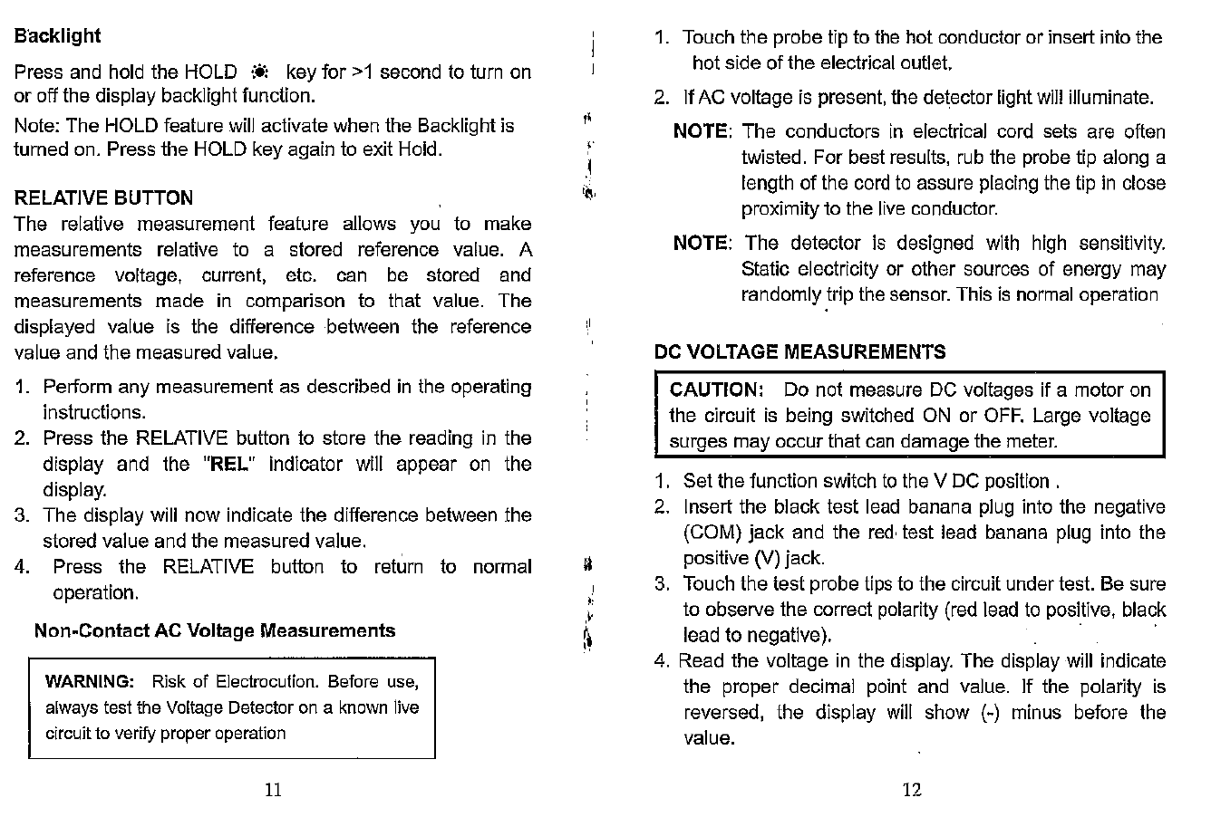

The above is from the operating instructions for the QM1323 Digitech meter. It calls the item a 'detector light'. It looks like the lens of a LED.

It says, "Non-contact" then explains, "Touch the probe tip to the hot conductor". That is not non-contact! My neon light bulb also glows when I DOO DAT.
My neon light bulb glows when it is very close to (but not touching) high voltage.
I didn't write the manual for this meter. You are correct. It is indicating real contact with the power socket and hot wire. It says to use a single probe... using it as an antenna.
It also means that the probe can make contact with the insulated hot wire without metal on metal contact and indicate the presence of voltage. The indication is only meaningful when it remains lit while in close proximity. I hold the meter itself close to power points, light switches and have not used a probe for this.
Note one describes the nature of a twisted conductor sheathed cable and warns that the position of the hot wire varies along its length. In some places the hot wire is closest to the viewed surface and at others, furthest away. That is the meaning of moving the probe along the length of cord.
