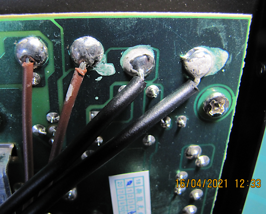

OK lets say your the quality assurance guy in the Chinese factory , making soldering equipment. ! yes soldering equipment , would you pass this unit ....
Yes of course!
Western guy just want cheap, quality cost money.
JimB .. 100+ GBP not that cheap ... ( I won't say what this part it is from as they have replaced the faulty unit )

OK lets say your the quality assurance guy in the Chinese factory , making soldering equipment. ! yes soldering equipment , would you pass this unit .....
I've seen MUCH worse and in, what are supposed to be, commercial products. Obviously (badly) hand soldered.

if it was here in the USA, and i were the inspector, no, i wouldn't pass it... unwetted wire, inclusions, bubbles, melted insulation ends, and one through joint looks like it has a ring in it....
yep, that's a NO-GO at this station....

Excellent picture to demonstrate what cold solder joints look like.
