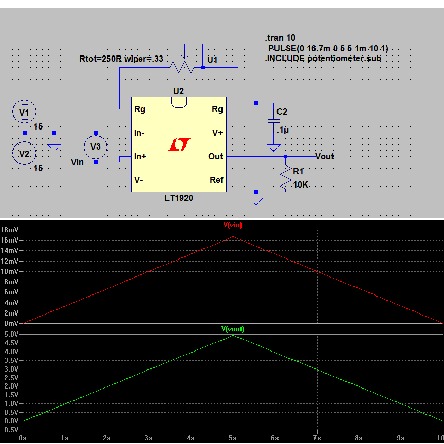

The output is going to an analog in pin of an Arduino Mega. My suggestion would be to use a dual supply, along these lines:
With 10 volt excitation Vout of the sensor 0 to 1.0 PSIG = 0 to 16.7 mV. The idea is to have a gain to convert the 0 to 16.7 mV to 0 to 5 Volts. This will afford the best resolution on the Arduino. The LT1920 I used is the same as the AD620 for all purposes. I covered the problems of using Vref (pin 5) of the AD620 with the needed gain. The AD620 data sheet in figure 38 shows a single ended supply configuration using Vref. Problems among other things is the Arduino does not have a differential input. Also with .0167 volts to get 5.0 volts the Gain will be about 300. I believe this will afford the best resolution and help with noise. The analog Vref could be changed on the Arduino I guess. However, the AD620 output will still be offset by any Vref on pin 5 other than 0 volts (ground).
Anyone have any ideas or thoughts to share? Read the other thread for more information.

Yes, I used a dual supply to make things simple and what I felt was the best approach. Cosel USA and a host of others manufacture small on board DC to DC switch mode power supplies which are inexpensive, 12 VDC in and +/- 15 VDC out would be idea as a dual supply. Also in my drawing I omitted the decoupling capacitors, you want a .1uf cap on the AD620 power pins to common. Right at the power pins. As drawn because I tie the -IN to Common the amp won't amplify a negative input. As I mentioned in the other thread the Arduino won't take a negative input anyway, not keeping things simple anyway. The Arduino also has input protection for negative inputs. However, a clamping diode could be placed at the AD620 output which would clamp anything negative at about .6 Volt. When setup the sensor should not see a negative pressure so it shouldn't matter.

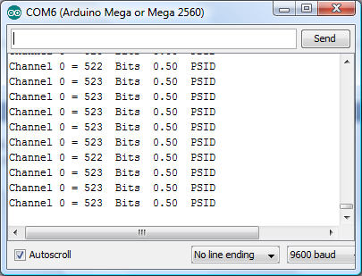

OK, I used an Arduino Mega and here is what you will have. The code is very basic and the monitor shows the results of the code.
  AnalogReadSerial
  Reads an analog input on pin 0, prints the result to the serial monitor.
  Takes the reading and converts to engineering units PSID.
  Connect output od Instrumentation Amp to pin A0. 0 to 5 Volt Input.

Here is what the above code will yield:
I am applying 2.5 volts to the Arduino Channel 0 analog input. You need to keep in mind that micro-controllers like the Arduino are not precision measuring devices. They are 10 bit A/D converters and not very accurate. For example with a 0 to 5 volt input and a 10 bit A/D I should see 0 to 1023 bits and with 2.5 volts applied I should see about 512 bits displayed. This particular chip is showing about 523 bits. That creates an error. I correct that error in the code where you see:
float voltage = sensorValue * (1.0 / 1023.0) - 0.01 ;
I subtract .01 from my conversion to PSID.
Using the PSID reading of 0 to 1.0 you will apply your delta flow math equation. When doing this you need to remember that when doing flow calculations based on flow across an orifice that the actual flow is not linear and is square law in response.
Finally, you can't just use a voltage divider to power the AD620 Instrumentation Amplifier. You need a dual supply to provide a + and - voltage with the ground 0 reference, exactly as I drew it earlier. Not if you want this to work accurately anyway.
I placed the conversion code on the Arduino only as an example. You may want to merely import the 0 to 1023 bits and do the conversion in your own software.
Ron

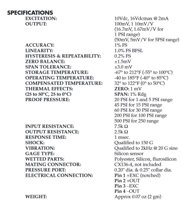

Hi, im trying to calibrate a pressure sensor. Trying to relate the voltage output to a pressure applied.
the sensor im trying to use is px26 001DV, differential pressure sensor. Any thoughts about this procedure.
thanks :)
I'm new using electronic circuits and stuff related, there are few terms i dont understand, I thought i'd would be better if someone gives me a small explanation on each of the parameter , what it means in the following list.
Following is an attached copy of Omega PX 26 001DV differential pressure transducer
Thanks & REgards
I see 23 different specifications. How about telling us which you are having trouble with so we can narrow it down a bit.
