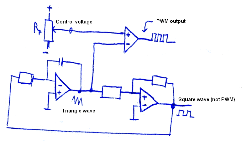

The usual way to achieve PWM control is to generate a sawtooth or triangle signal. Then feed this signal into the positive input of an comparator. On the negative input, you aply the control voltage, wich should have any value between the sawtoot signals most positive and most negative value.

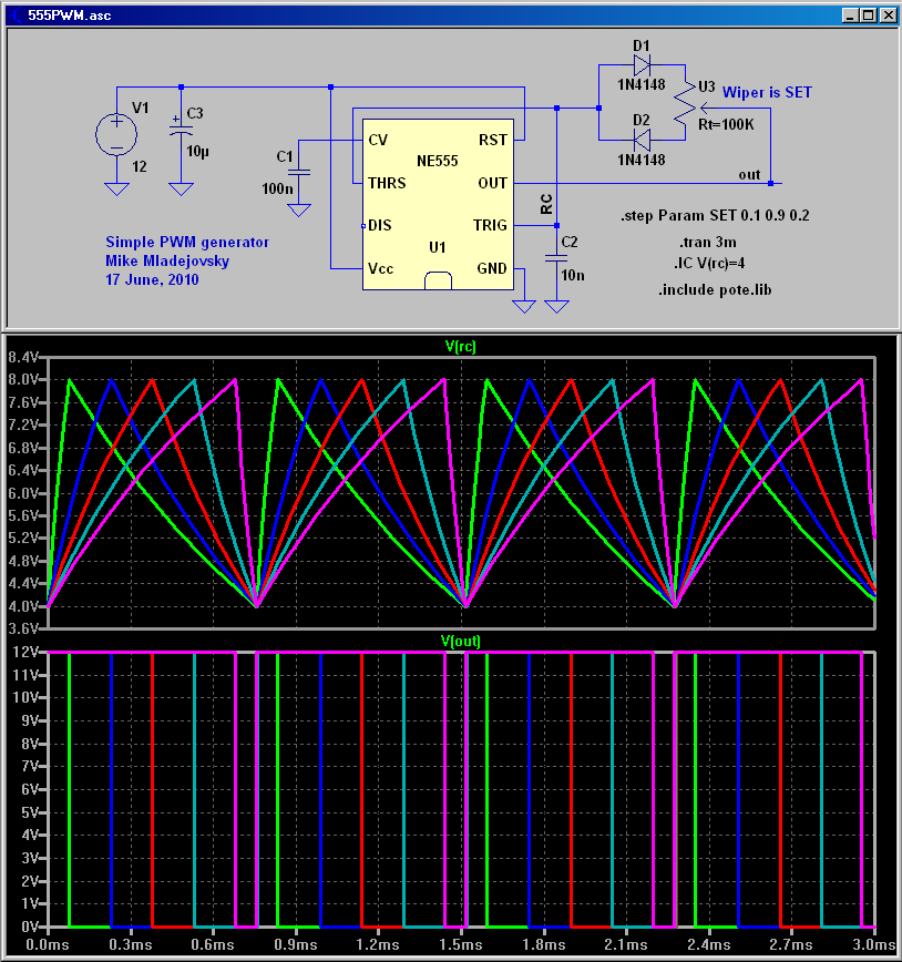

The only reason for doing it Grossel's way is if you are building a feed-back control loop, in which case the control voltage pot comes from a summing amplifier instead. If all you want to do is twist a pot, and thereby change the pulse width, use a 555 wired like this.
Yeah yeah I was thinking more of a twist pot type setup, and having never used comparators before either, I will give Mikes suggestion a go with the 555.
