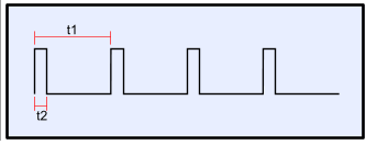

I have a smps device using 2 HGTG30N60 IGBTs .
After removing them and measuring the signal between the gate and source pins , i see a clean square wave but it is always set at 25 % even though am increasing the output current .
I get a signal like this one .

The power supply is indeed not working but the signal is still there coming from the control pwm ic.
I just want to make sure the signal is safe fro driving the igbts.

I mentioned the current increasing because i thought that when the current is increased i could notice the pulse width also changing , witch is not correct i guess .
Now what made me ask this question in the first place , is that previously after replacing the old igbts and using the same pwm signal , the PSU turned on fine with the right output voltage , but when the load current rised the igbts blew.
Now am confused weather the problem is from the signal or from bad cooling system .
The negative feedback loop is probably confused...
With the transistors missing, and so the PSU not producing any output, the control loop has probably increased the pulse width to its maximum - I'm surprised that it's not more than 25% though.
With the IGBTs removed you'll be able to test that the drive to them is ok (right voltages, nice clean edges etc) but you'll not be able to test the control loop.
You may be able to vary the pulse width though by injecting a signal into somewhere appropriate in the circuit to fool the feedback loop into thinking the output has increased.

I think the approach of the removing power devices so that the system can't destroy itself is generally a good one, but it imposes certain limits on what you can test.
