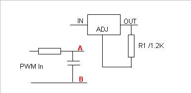

Hi thanks for the suggestions I read Mikes AP note as well & got some new ideas.
Forget about the 30V side lats say I want to adjust 1.2V-12V maximum.
Can anybody tell me how to connect the low pass filter to the LM317T?

PWM Duty Cycle * Vcc (5V, 3.3V, whatever) = DC voltage after lowpass. Pick a regulator with a control input pin OR scale the DC voltage by some gain factor (you can do this in the LPF at the same time and save an op amp) and connect it to the ADJ pin on a variable regulator.
Or if you don't want opamps use a bunch of resistors, schematic for that in the LMs datasheet.
It will not work. The LM317 is actually regulating the 1.2V and uses the current through that resistor to raise itself up on another while sending it's own 5mA of operating current to it's output.
You need an additional reference to compare the output to and regulate it with an additional transistor. Switching in resistors would require 40V transistors since the 30V when you try to disable one would blow out anything less.
Switching resistors is easy, but you need to use the right part. If I was working from my own junkbox I would use 7406 or 7407.
OP is going to have to use a high voltage part anyway to control the adj pin of the LM317 from 0V (1.2V out) to 28.8V (30V out).

No 12 of then will give you 12 bit accuracy that means 2^12 and that is 4096 different levels of output. This means you can control the output in 0,007V steps.
It will not work!!! You need to set your max voltage with the normal circuit (a resistor from out to sense and a resistor to GND) and then put a transistor in the GND line.
Then put a BIG cap from sense to GND, the value is determined by the response time you need.
Hi I just draw a diagram can you tell me is it ok? Because I have never worked on a similar thing.
