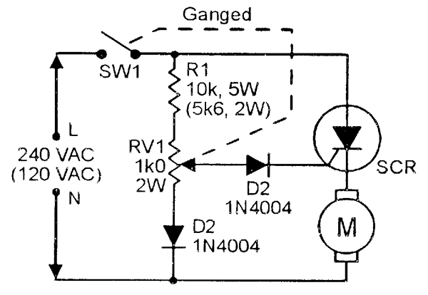

Does this circuit have a common name I can lookup to find a schematic ?
It's a low voltage version of a classic "drill speed controller". I saw the original low voltage circuit in an electronics mag back in the 70s, published as a model train speed control. It can control a train down to an inch or two per minute...
It can only work with a brushed motor, DC or "universal" types.
This is the simple half-wave drill speed controller version; at higher voltages and lower current they do not need the regulated gate supply; I added that for your 20A system...
The principle is the same; as long as the motor is producing more back EMF than the thyristor gate voltage, the thyristor does not fire.
When the back EMF drops due to the speed reducing, the thiristor fires and accelerates the motor.
