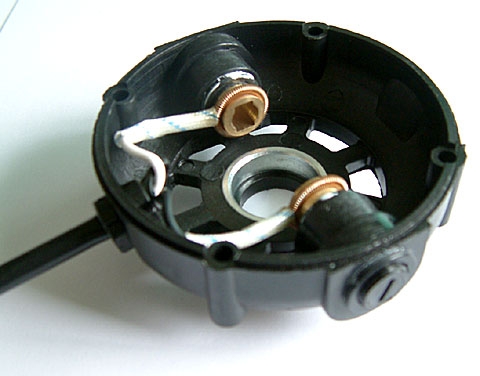

At school last year in tech, I used a mill machine with reverse, I think I was the only person to ever use the reverse! as soon as I tried it, the brushes fractured! according to my teacher the brushes wear a certain way depending on which direction you use most, and if well worn and then reversed they can fracture, no idea how applicable this is to you tho. Looks like a job for a IGBT or MOSFET

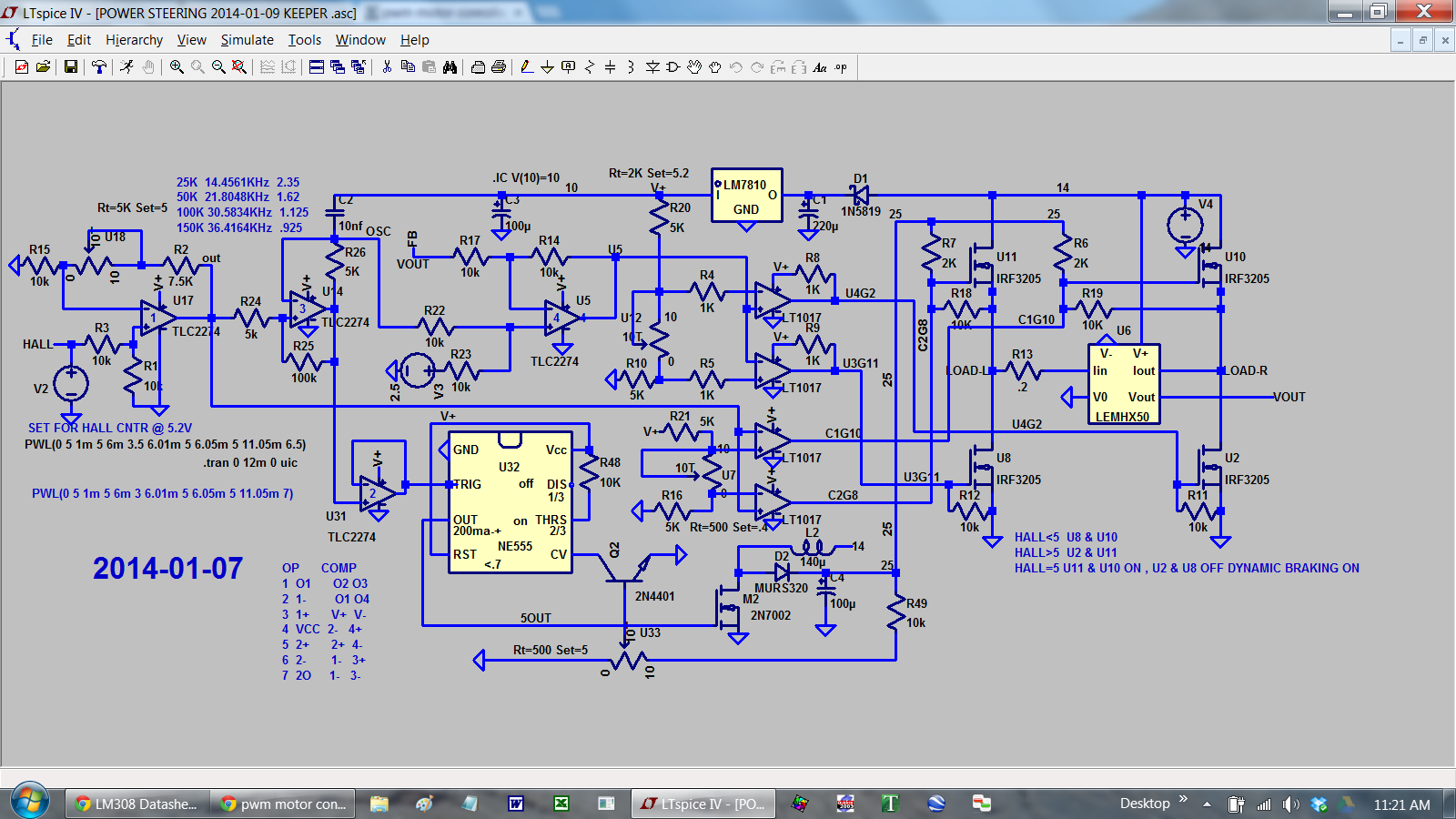

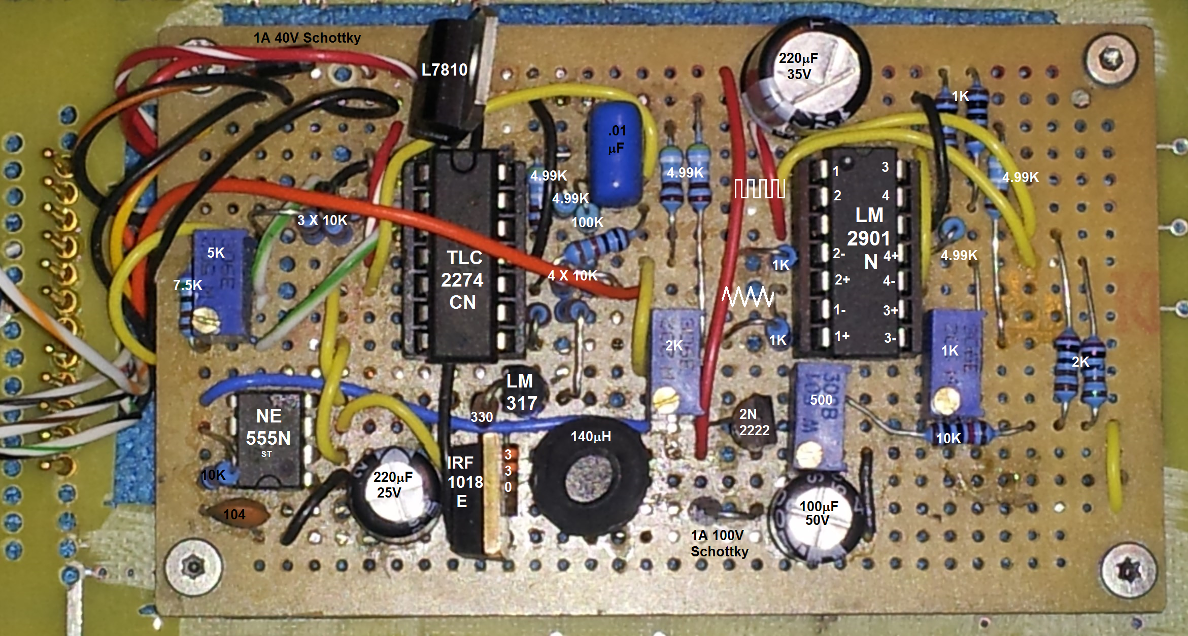

Here's what I'm presently working on for controlling the motor that assists my steering wheel in on off road vehicle and with just a few modifications, it could drive a 120 volt mill motor
The FETs are remote and connected by the pins at left along with power and feed back

Yeah I would go MOSFET H bridge route, IGBT's are all well and good but come at a price.

I believe your concern about reversing the motor is unfounded, the incident mentioned earlier was probably on a motor that had very worn brushes and hadn't been looked at for ever. Looking at the brushes in you photo, I don't think you'll have a problem.
If you're interested in my design, over current could be done with a single hall effect device, take a toroid core and Dremel a slot in it and glue a $3.20 Honeywell SS490 Series Standard Miniature Ratiometric Linear Hall-Effect Sensor into the slot and run one of your feed wires through it and then compare the output to a set voltage and you have your current limit. You can have your controller for 1 quad opamp and 1 quad comparator IC, under $6.00 for 2 PFETs & 2NFETS and a handful of lesser parts.
