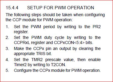

From the 4520 data sheet:
I have a 4520 so I'll have a go at knocking up some code myself......

Basic PWM code.....
/* 09:17 27 February 2013
 * PIC18F4520 / MPLAB IDE 8.89 / XC8 v1.12
 * E:\Electronics\PIC Projects\Electrotech\Shermona7\4520 PWM\PWM Main(1).c
#include <xc.h>
#pragma config CONFIG1H = 0X08;
#pragma config CONFIG2L = 0X19;
#pragma config CONFIG2H = 0X1E;
#pragma config CONFIG3H = 0X83; // MCLRE = off is 0x81
#pragma config CONFIG4L = 0X80;
#pragma config CONFIG5L = 0X0F;
#pragma config CONFIG5H = 0XC0;
#pragma config CONFIG6L = 0X0F;
#pragma config CONFIG6H = 0XE0;
#pragma config CONFIG7L = 0X0F;
#pragma config CONFIG7H = 0X40;
#define _XTAL_FREQ (8000000)    /* Not using xtal, only to make delays work as
                                it won't compile without this */
void pwm_init (void);
void main (void)
OSCCON = 0b01110010;        // Fosc = 8MHz
ADCON1 = 0xFF;              // No analog inputs
pwm_init();                 // Set up the pwm
/********* Start of main program loop **********/
 while(1)
/********** End of main program loop ************/
    TRISCbits.TRISC2 = 1;       // Disable pin output driver (CCP1)
    PR2 = 0xFF;                 // PWM f =  1.95kHz  / 0 to 100% duty cycle
    CCP1CON = 0b00001100;       // bit 7-6 Enhanced PWM bits (00 = single o/p)
                                // bit 5-4 Duty cycle LSBs (When 10 bit resolution)
                                // bit 3-0 ECCPx mode select bits (11xx = PWM)
    CCPR1L = 0x80;              // Duty cycle (8 bit)
    PIR1bits.TMR2IF = 0;        // Clear the interrupt flag
    T2CON = 0b00000101;         // Postscaler = 0, prescaler = 4, timer = on
    while (!PIR1bits.TMR2IF)    // Wait until the Timer overflows and the
    {}                          // TMRxIF bit of the PIRx register is set.
    TRISCbits.TRISC2 = 0;       // Enable the CCPx pin output driver by
                                // clearing the associated TRIS bit.
You haven't said which IDE you are using. If you are using MPLAB IDE then it's easy to run this code in the simuator, that way, in the absence of a scope, you can observe changes to duty cycle if you want.
