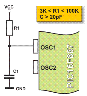

After many failed trials of using a Potentiometer to adjust PIC output (DAC) and (ADC), I'm thinking to try making a variable RC Oscillator and get the clock change to get some variable PWM output. Is this sounds rational or not ? :)

That is a complicated way to get variable frequency PWM. Is that what you want? You won't be able to (easily) change the duty cycle of the PWM with a changing oscillator frequency.
Yes that what I need for now "variable frequency PWM" as an introduction into PIC analog issues.
It was a crazy idea came to my mind :)

Now I'm really confused about what you are trying to do :) Which one are you trying to control; the frequency of PWM or the duty cycle of PWM? or both?
What in mined is how to use PIC to control a load ( LED or even LCD segments), by adjusting a Potintiometer, to show a kind of inication in response to the POT changing. This a PIC analog issue, isnt it ?
You do realize that changing the frequency of PWM signal does not change the average voltage? It does not make a LED shine brighter or dimmer. You need to change the duty cycle of PWM in order to control load.
But your idea of changing the speed of the RC oscillator with potentiometer is perfectly good if you want to make a LED blink faster and slower.

I don't want to get rid of you. Just answered your original question :) Your idea is perfectly good and rational if you want to control the frequency of PWM. I'm just not convinced that controlling the frequency of PWM is what you really want to do. You said you wanted to control PWM.. and that is a little bit confusing because there are two things to control; frequency and duty-cycle. You can't control duty-cycle by varying the oscillator frequency.
