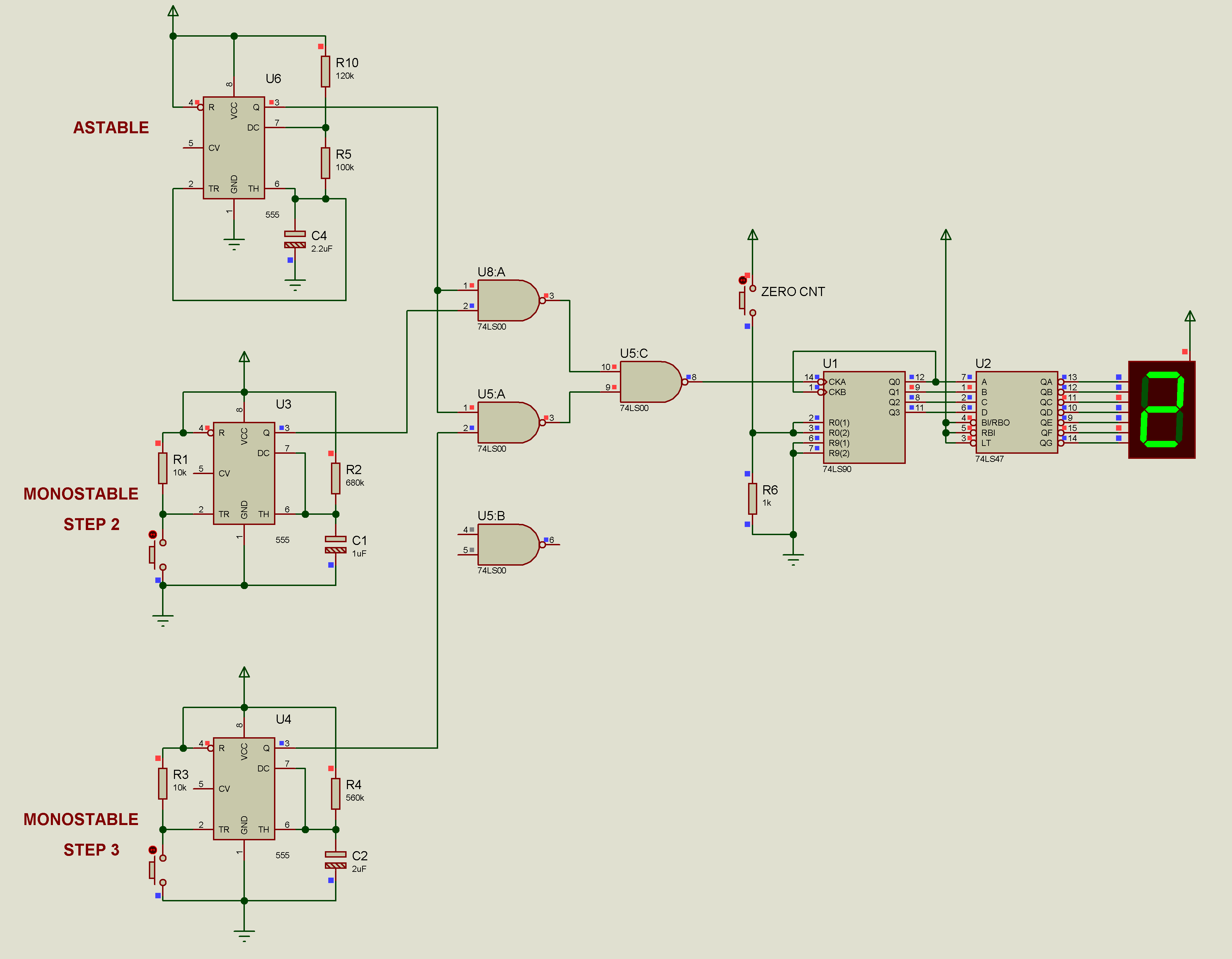

Hi im new to this forum and i really need some help. My professor gave us a project to make a scoreboard. The materials to be uses are lm555,74ls90 and decoder ic. Im stuck on the first step because our professor didnt explain clearly. I just know that we need 4 buttons for 1 point 2 points and 3 points. I really need some help and if you can provide a schematic, it will be greatly appreciated. Thank you!

Here is how to do it with three (or four) 555's:
555#1 is the clock (astable) oscillator. This sets how fast the multi-point changes happen. I suggest 2 Hz.
555#2 is a monostable that enables 555#1 for 0.75 seconds. This lets two clock pulses go to the 7490. The instant the clock 555 is triggered, its output goes high; that increments the 7490 by one count. 1/4 second later the 555 output goes low. 1/4 second later (1/2 second total) the clock output goes high again, and the 7490 sees a 2nd clock edge. The last 1/4 second is for margin in case some of the circuits are running a bit short or long.
555#3 is a monostable that enables 555#1 for 1.25 seconds. This lets three clock pulses go to the 7490.
One button goes directly to the 7490 for single-point changes. For consistency, this can be 555#4 acting as a switch debouncer.
The three signals are combined in a NOR gate before going to the 7490 clock input. This is because the 7490 increments its count on the negative-going edge of the clock signal.

Here's a reproduction of the description of ak's circuit idea. I purposely left out the single step pulse for you to fill in the blank. Hope this is not Homework or else the Mod would delete the schematic if he sees fit.

absf - thanks for the effort, but you're not quite there yet. The monostables have to hold the astable 555 in reset to guarantee that it always starts with a complete cycle. In other words, the gating has to come before the astable, not after it.
