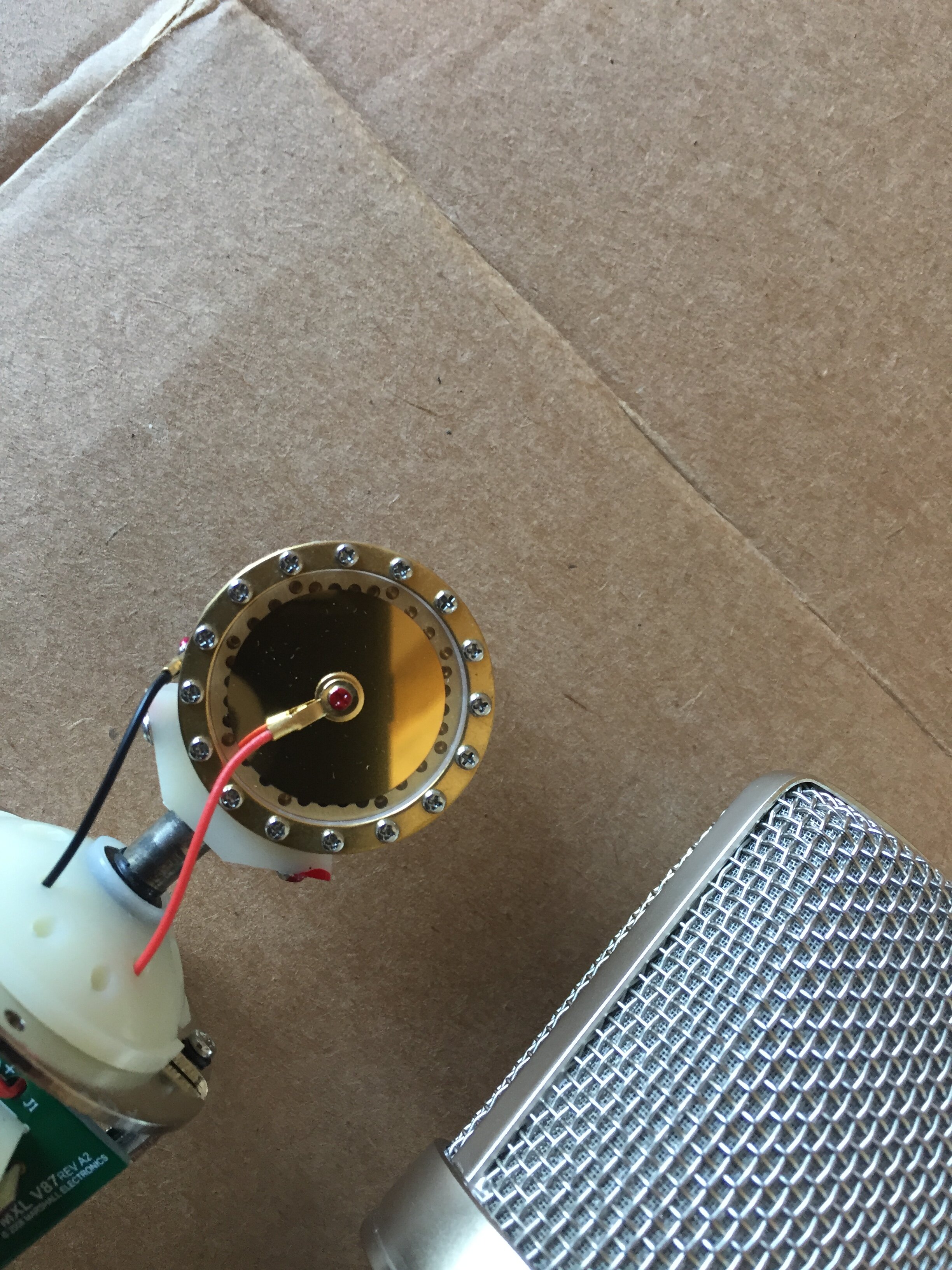

That picture you showed is how easy it is to make an electric microphone.
Capacitors do not in themselves (or with resistors) oscillate, and caps do not pass steady state DC.
Carefully read my post in your thread on Ohms law.
An "electric microphone" does not mean anything? - all microphones are sound-to-electricity transducers, regardless of the specific technology they use.
If you mean a "Condenser microphone", then they are similar to but simpler than an electrostatic speaker)
eg. This is a condenser mic capsule - the inner disc is on the near side of an insulating membrane with the centre connection & the other electrode is the perforated brass plate, with the spacing set by a thin insulator disc behind the clamp ring.
