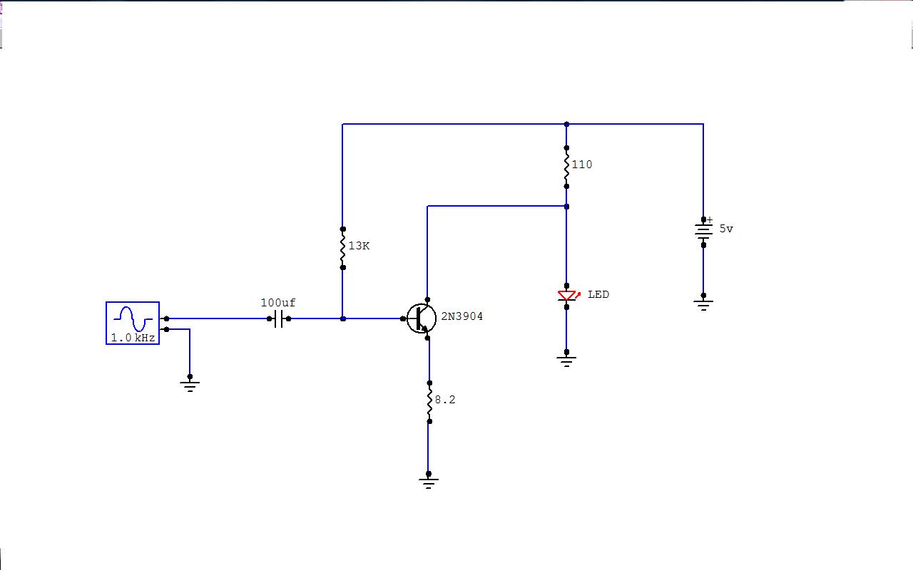

Pulsing LED to Audio using a 2N2222 transistor.

After a little bit of messing with it, i've added a 10k resistor between the positive and negative audio input lines. I'm not sure why, but this fixed it and now the circuit works exactly how it should. ..one day i hope to understand why. =)
Here is the current schematic for the working circuit:
Thank you all for your help!
Since this thread is being brought back up again, here is a quick and very primitive sound to led light circuit for a build if anyone is interested.
It works in a very simple way, but it works.
