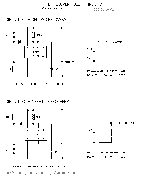

Im working on some pulse delay circuitry but couldnt handle yet , so need some help over here :stop: !
Currentl i need a delay time,when every time pulse applied. The delay time will approximately about 1uS to 100uS. Already searched on internet aand found a scheme which was ok for me but . Im saying ok cause the circuit is reversing the pulse and it is decreasing positive width. I desided to try in real and the result was so much weird. Cause the circuit is working with 555N but not working with 555P !!Here is the scheme of the circuit. In my country i couldnt find out 555N so my plan failed.

yeah i should give more infos ,sorry.
For example the pulse has 200uS on time and 200uS off time (400uS period). I want to make a pulse like 180uS on time. I mean i want to create something like deadtime. By the way im also looking for a pulse phase difference circuit.
I was doing this circuit in pratical. But couldnt get what i want to make.Let me explaine what i got from that circuit.
I simulated the circuit via Proteus 8 and its working exactly i wanted. R1 is varying delay time of rising edge, and the R2 is varying delay time of every fall edge of pulse. If you vary two of them synchronously you are making phase difference. That was perfect in simulation and this is all good for my desire.
Now in practical , i used 74HC14 for hex schimtt inverter against of cd40106. (There were no difference in simulation. ) In practical i can only vary delay time of rising edge about 200uS and more. Not less then 200uS. Max rising edge delay time is huge like 5-6mS. The problem i need 1uS to 100uS delay time. And also when i use a capacitor between Vcc and GND of ic , the output signal reversing with no reason that i couldnt explain ! And also when i decrease R1 less then a few kiloohms , i got a freq divider. The period of the input signal is , on time of the output signal (half of the freq).
I hope i could explain,what is my problem. Sorry for my english :smug:

The actual delays will be proportional to the circuit R-C time constants and in the example the values give relatively long delays.
Changing the caps to eg. 330pF should give nearer the times you need.

I got it master thanks.
But i should learn something. How did you calculate cap value ? Is that Tau equition ?
Good to hear it is working!
The minimum time was 200 times too long, so 1/200th of the original 0.1uF ( = 500pF) as a starting point.
Then adjust that down a bit more to allow for stray capacitance and some "spare" range at the lower time end of the scale...
