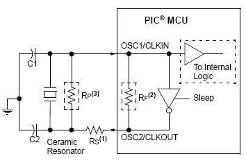

    Chip = 16F1829
    Ceramic resonator: muRata (source: DigiKey), 8 MHz
    PCB = soldered breadboard FR4
    Problem: In HS mode (datasheet specifies that mode for 4 MHz to 20 MHz), frequency is 0.3% high. Still within spec, but would like to pull it lower. Rock stable for frequency. In XT mode, frequency is better, but not as stable.
    Attached an EZ micrograbber to one leg (OSC1/CLKIN) and frequency got better. The datasheet shows some external resistors:
    Space is very limited, so any modifications take more time, even just swapping resonators. I am wondering whether it is being over-driven. Question: Can RP and/or Rs be used to pull the frequency down?
    Other suggestions?
    John
    BTW: Curious bit in the errata: The OSTS status bit remains clear when using 4XPLL through version 4. Problem was easily discovered. I guess I wasn't the first to find out.

    I would expect C1 and C2 to have an effect on the frequency, the same as they would with a quartz crystal.
    Increase the values to lower the frequency.

    Yesterday, I tried a cap labeled 4 pF and it pulled it way too slow. Based on your comment, I remembered that I had some smaller ones. It looks like about 2.2 pF does it. And, I can probably get it squeezed in.
    Thanks for jogging my memory.
    John
    Edit: 3.3 pF (label) got me to 0.1% high after soldering. Of course, with a temporary lead to ground, it was right on. ;)

    Why not use a small variable capacitor (trimmer).

    For a final version, I might put a little trimmer there or use my SMD's. It is really easy to put those things in parallel. This is just to get my lightning detector antenna tuned up. For now, I can live with 0.1% as it is very steady compared to using the internal oscillator on the PIC.

    My first choice was, of course, the capacitors. Unfortunately, I had forgotten that I had some leaded capacitors less than "4 pF" from another project. So, the crux of my question was whether those resistors shown in the Microchip schematic could be be used to pull it slightly lower.
    Then, I remembered that I had some mica capacitors down to 1.0 ± 0.5 pF and ceramics a bit higher . They are relatively huge but solved the problem. In another thread, it is asked what is on our "to order" list. I have added some 3.9 pF ceramic, COG capacitors, as my choices were 3.3 pF and 4.7 pF. The latter was too high. My capacitor meter is a DE5000 LCR, which is generally quite satisfactory, but fails in sorting such low value capacitances.
    My main concern was linearity about the target frequency. From 436 kHz to 564 kHz, the response is absolutely linear (given 0.1 kHz resolution), so I am not particularly worried about that small offset now.
