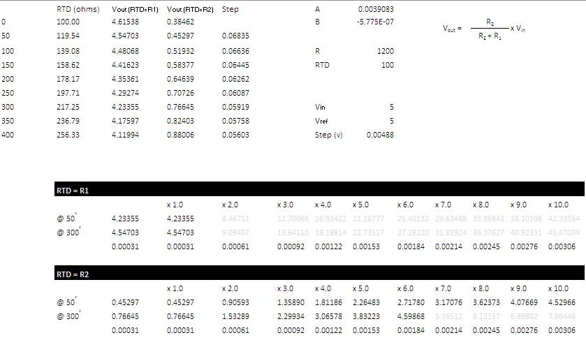

Not too sure about what you meant by amplifier and offset (I am kinda new to this), but the best results (only in calculations) I managed to get where using a voltage divider and 1200ohm resistor as R1 is:
  • Mininum - 0.453v
  • Maximum - 0.766v
Then using a x6 voltage multiplier it will give me 2.7v to 4.6v

I am familiar with that. I have managed to calculate the various PT100 resistance values using the widely available linearisation equation:
Rt = R0 * (1 + A* t + B*t2 + C*(t-100)* t3)
Also see the attached snapshot from my Excel file.
The questions is how do I reduce the 0.453v of the voltage divider Vout to be 0v?

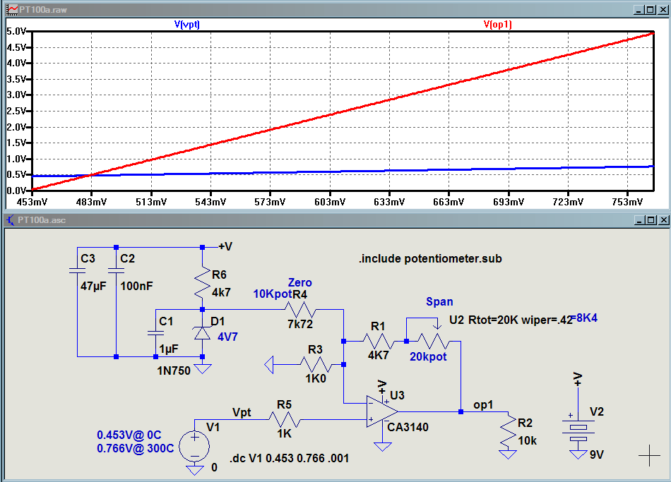

A circuit like this would do the job.
Note the OPA type, the LM386 isnt suitable for your application.

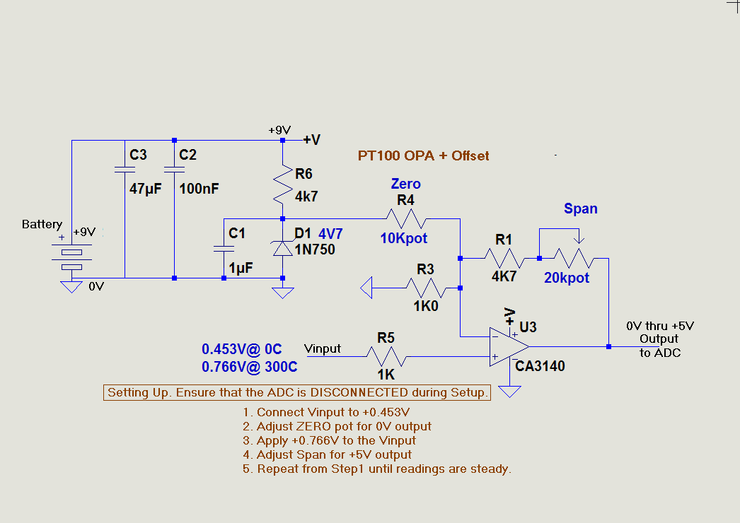

I'll post a schematic, that first circuit is from the simulation program.:)
Look for a LM358 that should be close enough for your project.
Look at this simplified drawing.
Can you follow it OK.?:)

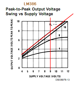

You said the LM386 is not suitable, but why? It seems to be doing the same thing as the CA3140.

So in a sense the amplification for this OP AMP is quite similar to how the LM386 works, it is set by the ratio of R5 and R1+SPAN. Am I right?
The Gain [span] is set by R3[Rin] , R1 and the 20Kpot [Rf]
And as for the offset, if I understand this right, it is a simple resistor (pot in this case) reducing the voltage by 0.453?
R4 is the Zero pot, connected to the 4.7V ref voltage
Other than, I just have a few more questions (sorry for all the questions):
  • What is the purpose of R3?
    As above, its Rin
  • What is the purpose of everything before R4? (the diode, capacitors, extra resistors)
    The caps are for power rail decoupling. The 4.7V zener diode provides the Vref voltage for Zeroing
The voltage swing range of the LM386 output is not suitable for the application.
