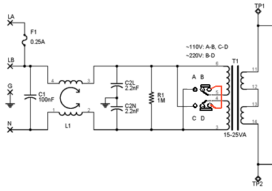

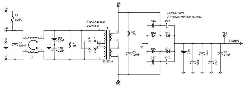

Hi there everybody,
I've got a PSU which i'm building and I need to make it dual voltage (110/240v) switchable. The circut is already built to accomodate this, but my question would be, what sort of switch/pair of switch types would be good to accomodate this? I initially wanted to use DIP switches for ease (hard to confuse which one to switch) but after realizing most DIP switches have a low voltage & current rating, i'm asking for help. Another alternative I also thought of would be a pair of DPDT and SPDT switches.
Please do advise on the best method of addressing this issue. Thanks!
You use a single DPDT switch, of the type slide or toggle, as shown. Please ensure that you only change the voltage setting with power OFF.
I would be careful about any easily operated switch, it could be too easily operated by accident!. Usually such switches are recessed to prevent this, or, going back even further, you had to remove, rotate, and reinsert a plug to change it!.

Thanks for the insight, everybody.
I had already thought the whole switching power issue over before implementing it (i'm in the states now, but when I go home to 240v...) so it's more of a "maybe twice a year" option. I guess i'll wire up the switch internally and if I want to change voltages, i'll just open the whole thing up again to flick the switch.
