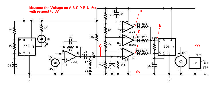

I've had some troubles with the sensor.
When I power it, the piezo starts bipping non-stop, no matter where the leds are. In fact, even if the two leds are disconnected, it still bips.
- Both LEDs are working fine (I tested them out of the circuit with a DMM)
- D3 shows continuity on both ways - a diode shouldn't do this!
- C1 shows continuity on its leads.
- C5 shows continuity on its leads.
- C6 shows continuity on its leads.
- Not really sure about C4, but I think this one is ok.
Do you have any clues.
The buzzer I'm using is rated at 6v, although the circuit is optimized for 12v. However, I power it with 6v and it works the same way - a constant, irritating beep.
Do you have any clue on what is going on here? Can you help me out?
Here's the schem:
Firstly, you have presented a circuit diagram with no component values.
Secondly, if you are measuring components "in-circit" you have absolutley no idea about electronics.
You have taken on a circuit that is far too complex for your ability.

Hi DW,
Look at the attached image, measure and post the voltages at the points A,B,...E , and +Vs.
I'll let you know what to do after I get your readings.:)

Will do, probably later this afternoon. In the meantime, I've been 'poking around' with the ICs and I think the problem is near IC4. Without IC1 and IC2 (only IC3 socketed) I get the same bip.

+Vs - 9,6v
A - 0,48v
B - 0
C - 0
D - 0
E - 0,05v
Though I have to add that these were taken without IC1 nor D1/D2 (IR Led/receiver).
I'll take note of those voltages with IC1+D1/D2 later today.

hi DW,
The +Vs should be at +12V.
The A is OK.
The B,C,D should be at 0V for no signal to the D2 IR detector.
Also the E voltage is OK.
If the wiring on IC4 is correct then pin 3 should be close to 0V and the buzzer should not operate.
Are you using TTL 555's or CMOS 555's, recheck pin3. Let me know.
I suspect pin3 is about 1V or 2V, this would cause the bleeper to beep from time to time especially its a lower voltage bleeper.
IC4 (NE555)
1 - 0v
2 - 0,05v
3 - 8,2v
4 - 9,52v
5 - 6,3v
6 - 0,05v
7 - 0,05v
8 - 9,52v
As pin 3 is high at +8V the beeper will sound, does it make a continous sound.?
Have you tried holding the 555 with the emitter diode close to the detector diode.?
Also as I said earlier the circuit is designed for 12V operation, not 9,52V.
The circuit works OK in simulation, the only problem with the design is that the beeper 555 is not RESET at power up and so it requires that the detector diode 'see's the emitter so that it can time out, then its ready for normal operation.
I already tried it at 12v today at school, but with no luck.
It does make a continuous, non-stop bip. Yes, I've tried with both LEDs, close together.
Post a photo of the front and back of the pcb, showing the components.
When you say a 'continuous, non-stop bip', is the buzzer going on and off, if so what is the approx rate.?
Do you have access to a scope.?
Non, the buzzer is not going on and off. It's going on, always. It never stops.
Unfortunately I do not have access to a scope.
Isn't D3 working badly?
