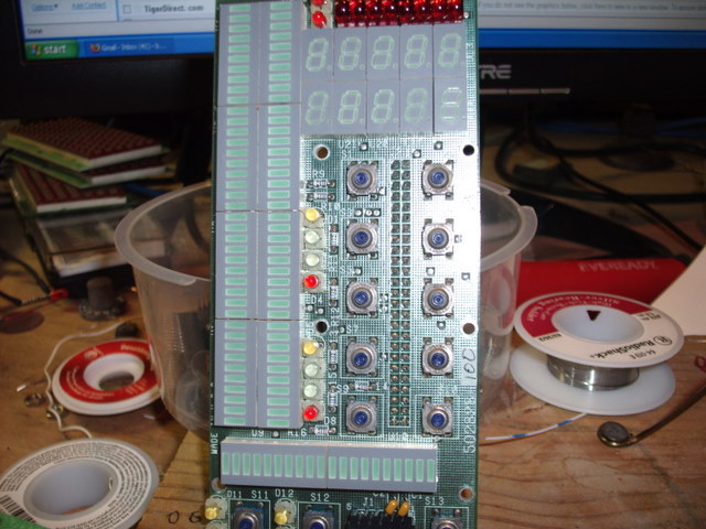

I have a bunch
gedc0277-jpg.25246
of this
Spend a little more $$ and make it easy on your self
