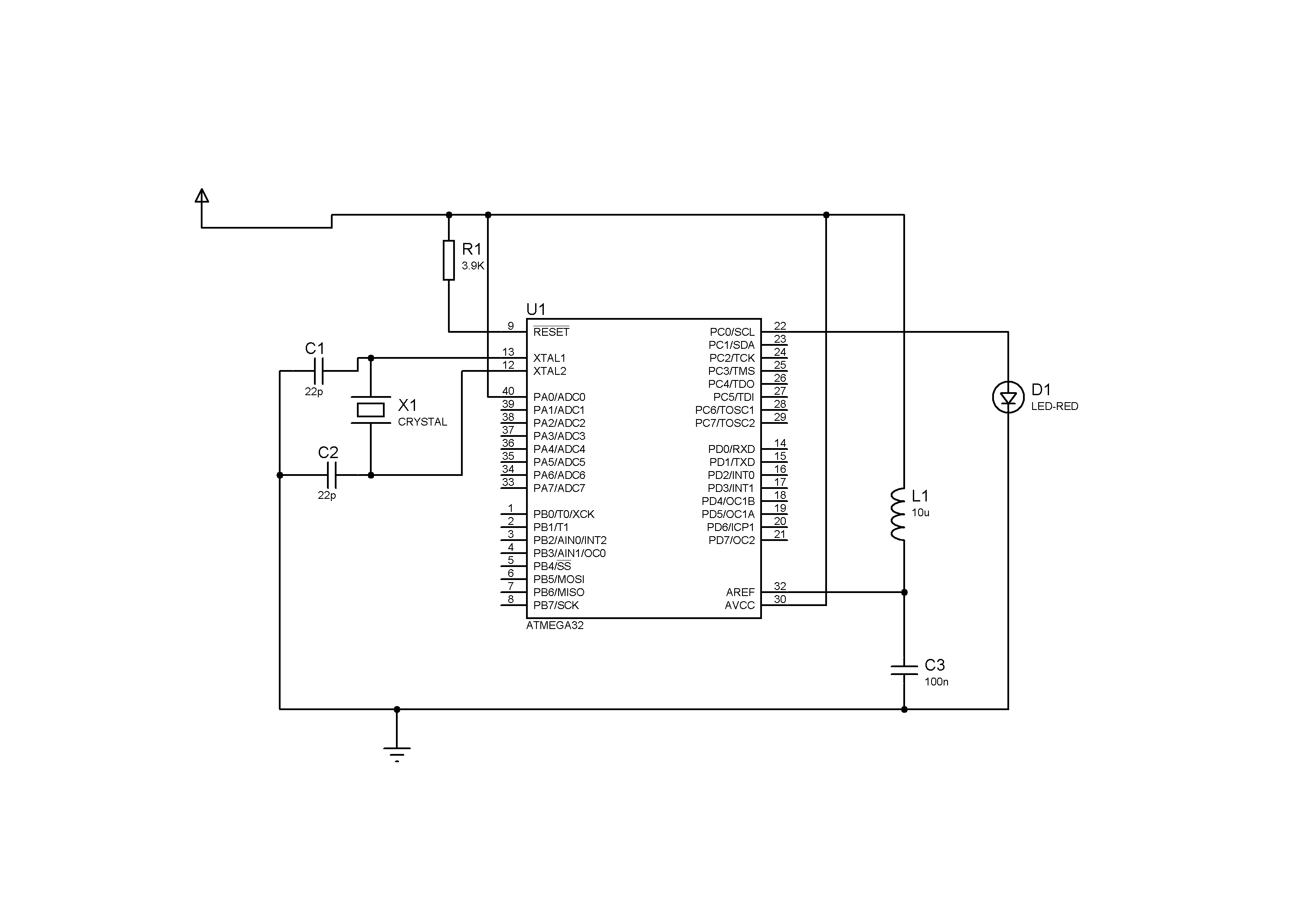

Hi everyone. Today i was testing the Micro-controller simulation in Proteus.

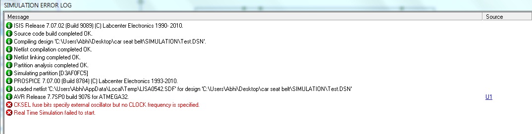

I built a circuit as shown below and loaded the .hex file. When i try to simulate it i got an error.
"CKSEL fuse bits specify external oscillator but no clock frequency is specified"

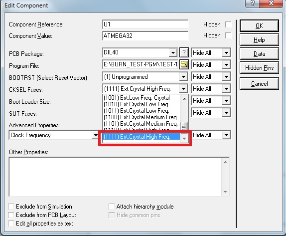

I have used 12MHz crystal and selected external clock source but it isn't working. However, if i select internal clock option ,everything works fine.
Please correct me.:confused:

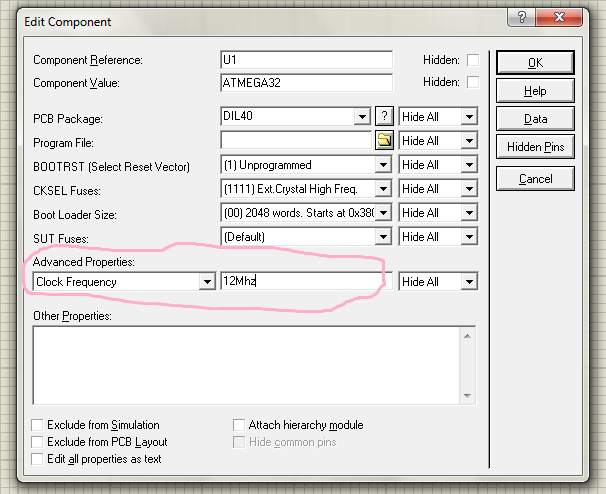

I think you have to change your clock frequency from the 'default' to '12Mhz'(or whatever u want to use) in the advanced settings dialogue box.
Check out the pic. i attached.
Also don't forget to assign the same frequency to the crystal,I mean right click the oscillator and change the clock frequency to 12Mhz(or whatever u want to use).
Try these settings and even then if it didn't workout let me know.:)

Thanks a lot sir. It worked :D
