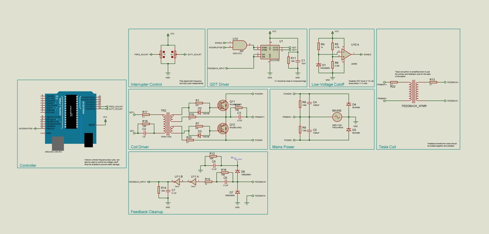

For some reason I chose one of the hardest circuits to simulate: a solid state tesla coil. It's tough to simulate because each "section" relies on another, so it is difficult to simulate the circuit one section at a time like I normally would.
The circuit involves transformers (gate drive transformer, feedback transformer, etc) which seem to always cause convergence issues ("Time step too small) when I run the simulation. I have tried different values for GMIN, RTOL, and all those options in the Simulation settings but still I have no luck. I also placed high value resistors in parallel with capacitors and low value resistors in series with coils, which helped a little bit once but then something else started happening and I ran into even more convergence issues. I have ended up with a "design" that is less like the circuit I will be building in real life and more like a circuit designed just to be simulated.
This SSTC uses an arduino to generate an interrupter signal, which is passed to a UCC27425 dual MOSFET driver with enable. This chip drives the GDT, which then drives two IGBTs. Since the UCC27425 has one inverting and one non-inverting driver, the IGBTs will alternate between each other which is turned on and which is turned off. This causes an oscillation on the primary. The secondary then has a feedback transformer which passes a signal (which is cleaned up by the 7414) back into the 27425 as an input, and the cycle is repeated.
For those who do not have Proteus 8 and want to see the circuit, here is the schematic that I currently have in the simulator:
I included my project file and the hex code for the Arduino in the following ZIP folder.
Again, the main issue I have been having is with convergence, and that is even after applying the simulation settings for better convergence.
Any thoughts of what may be going wrong would be very much appreciated. I've been banging my head for the past couple of days trying to figure this out :p
Also please note that the UCC27425 is a custom device, and that its child sheet contains the internal schematic.

I have (tried) to get simulation running by using a variable pulse as an interrupter...
Its complaining that a "node #V:Q8:fi1 #branch" is having problems.... But this node isn't in the schematic..
I have found in the past that transformers in general are horrible as well.... They haven't a ground reference and ISIS doesn't like it..

I decided to connect PRIMARY- and FEEDBACK- on the transformer together to see what happened, and the simulation runs. This means that you're probably right about it not liking the lack of ground reference. However, this bypasses the mains source, so the circuit will not simulate properly when I have this connection made. So I'm still hitting a brick wall at this point, since I can't ground the transformer due to how it's connected. I may have to redesign that portion of the circuit altogether and see if there's a way to make it work.

I wish there was a way to bypass the error coming from the transformer not being grounded. It seems pretty stupid if you ask me that a transformer MUST be grounded on one side--there are many circuits in the real world that do not work that way.

Well I was able to get around that particular transformer issue by grounding the lower windings on the schematic through 1GΩ resistors, but I still run into the "trouble with node" error with the link that returns "branch not found". I guess that's the main problem at the moment.
