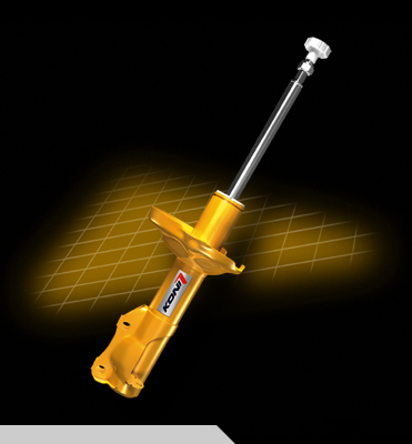

On my car, I have installed some Koni adjustable struts.
What I would like to do is build a system to adjust them remotely, from the drivers seat.
-In the picture, the white knob on top of the strut is the adjustment knob. It slips on and off, and is only used for manual operation.
-The actual piece being operated is a small flat ear similar to a flathead screwdriver tip, about 1/2" wide.
-The range of motion is 2 full turns.
-There is very little torque required. can be done by fingers
-In a perfect world, I would be able to adjust them back and forth from the drivers seat to a minimum of 4 distinct positions, but more would be okay.
-I need to know exactly what position they are in at any given time, so either through switch position or indicator lights would work.
-There are four struts, but they should be operated in groups of two (front and rear separate)
-Space available is very limited
In my attempts so far to figure this out, I am getting the idea a stepping motor might be the way to go, but I am really only guessing. There may very well be a better option out there. I understand that a stepping motor needs some sort of controller, but I'm not really sure how all that would work...
Any thoughts about how to do this?

This is not a trivial task.
You could perhaps use a stepper motor such as this with a driver such as this.
But then the question is how to generate the number of steps for the desired motion. A microprocessor would require the least number of parts for this but you would have to learn some programming skills. Otherwise it would require some counters and other logic to generate and keep track of the number of steps, and the direction of motion.

What about a regular, low rpm (or geared for low rpm) motor with a time delay relay?
Time the full rotation, then set the TDR to cutout after the desired amount of time. I would have to figure out some other way to indicate position...

You can't accurately control the position by time due to differences in the motors, temperature, voltage, etc. You could perhaps control position by putting one or more micro-switches activated by cam(s) on the motor output shaft. You could have a toggle switch to control direction and a push button to activate the motion. The motor would stop when the next cam position opens the microswitch.
If you wanted an indication of the position you could use an up/down counter circuit driving a display to count the number of cam switch actuations. The counter would count up for one position of the directional control toggle switch and count down for the other position.

Your hobby servo idea might work. If you could get 3 turns of wire around the shaft then size the lever arm on the servo to get your 2 turns since the servos only rotate about 170 degrees. This would be easy to control with a 1 IC circuit.

The hobby servos are controlled by sending a pulse between about 1 ms to 2 ms. Less than 1.5 ms moves one direction, greater than 1.5 moves in the other direction. This circuit (2nd one) would let you turn a knob to set the position.

Would this be doable?: A servomotor with a rack and pinion style gearset to drive both the adjusting screw and a series of microswitches to actuate indicator lights.

That would work but how will you keep track of two revolutions? You could, of course use a 2:1 reduction from the adjusting screw position so that the sense cam would move one revolution for the two shaft revolutions. Perhaps some type of hobby gears would work for that.
