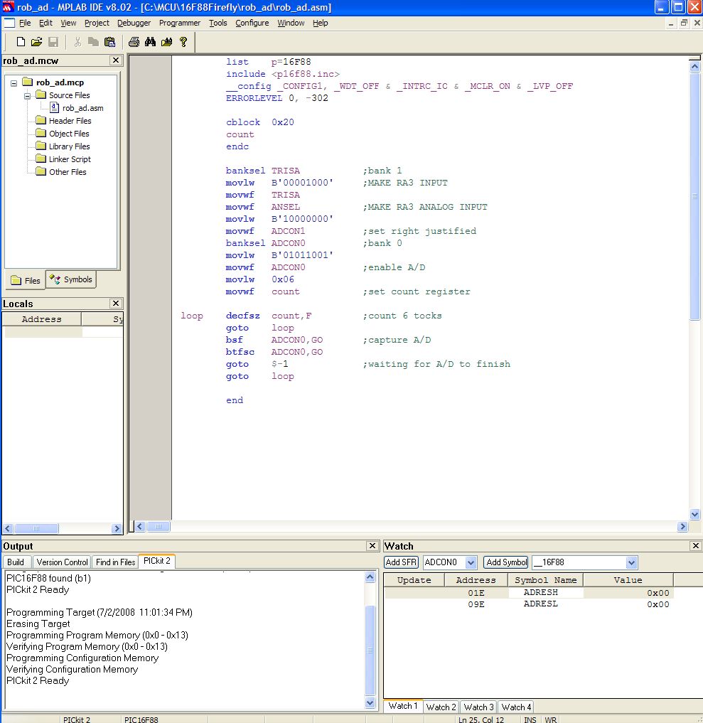

Screen looks like this
My Firefly dip switch is set to 010111
The PICkit 2 is plugged into the Firefly and connected. Powering from PICkit 2.
2. I click on Debugger/Select Tool and select PICkit 2. The PICkit 2 connects.
3. I hit F10 to assemble the file and wait for it to be done. When it reports BUILD SUCCEEDED I continue.
4. I hit ALT-D and then the G key to program the PIC on the Firefly with the assembled program (executable) and the debug monitor.
5. If I didn't already have one up, I'd now open a Watch window by clicking View/Watch. Then I'd get ADRESH and ADRESL displayed in there.
6. Now I put the cursor on " goto loop", right-click and select "Run To Cursor". Wait a bit. Look at ADRESH/L.
7. Turn the VR2 pot a little and goto step 6. Repeat as necessary. ADRESH/L change as expected. Fully clockwise is $03ff and fully counter-clockwise is $0000.
I do all that, but the MPLAB is very slow, and it is stuck on:
btfsc ADCON0,GO
And I only get two reading on the ADRESH/L that is 0x08, and 0x40. And I don't get anything else....
Mind you, it's a big step from nothing before... Just have to find out why it's so slow.

You say you have all LEDs lit on the Firefly? I don't. With the above program I get #1 Red and #2 Green and #3 Off. Sure you have your project set up right? The Project window should have the correct source file listed. If you have the wrong one in there it doesn't matter what's on the screen. It assembles the one listed there anyway and if the one on screen is different it gets ignored. I've made that mistake and spent 20 minutes cursing as it assembled a the wrong program over and over, ignoring my frantic changes to the onscreen source.
OK I got the switches at 010111, I went through the process step by step, and I have the pot all the way up almost, and it's running
Three of them go red, but ADRESH/L stay black
