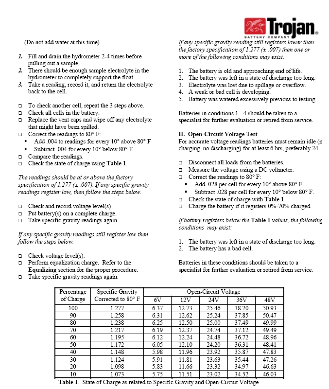

Meanwhile, I have some readings from the hydrometer for some (not all) of my battery bank. There are 8 batteries listed below; 6 cells each. Is there anything here that gives an indication of a bad cell? I noted for example on battery D4 that two cells were much lower than the others; is this the sort of thing we're looking for? Also, D1 and E4 are at very different levels; is this a sign of a problem?
Hydrometer Readings:
Battery D1: 1.15 1.12 1.13 1.14 1.13 1.13
Battery D2: 1.16 1.18 1.18 1.18 1.18 1.19
Battery D3: 1.19 1.19 1.18 1.17 1.18 1.16
Battery D4: 1.18 1.16 1.17 1.16 1.12 1.10
Battery E1: 1.15 1.16 1.18 1.16 1.15 1.18
Battery E2: 1.14 1.15 1.16 1.14 1.14 1.16
Battery E3: 1.20 1.19 1.20 1.19 1.19 1.18
Battery E4: 1.23 1.22 1.22 1.22 1.23 1.23

Attached is the table that I referred you to from Trojan Battery Co. Make note of the temperature corrections, but it appears from your measured SGs, your batteries are all over the place, with 1.10 being only 20% charged, and 1.23 being 80% charged. If I saw this much variation in SGs in my aircraft or boat batteries, I would conclude that they need to be equalized.
Letting batteries sit for months without periodically recharging them to near full charge is the worst thing you can do to them. Flooded lead-acid batteries loose 10 to 15% of their capacity per month if left idle. Partially discharged batteries form hard suphates which are almost impossible to remove. The only thing that prevents formation of sulphates is to keep the SG of the acid at 1.25 or higher. One way to keep the SG high is to periodically (~every week) charge them to where they begin gassing. Another way is to float charge at <2.15VPC, which doesn't add charge, but prevents self-discharge. Float charged batteries should be equalized once every two or three months.

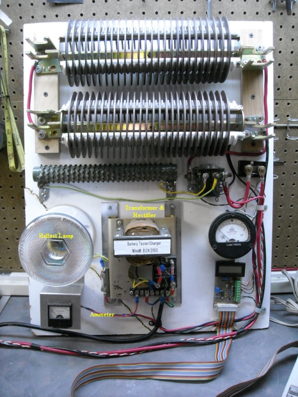

To equalize your entire string at the same time, you would need a current-limited (at about 3A) power supply with an open-circuit voltage of 310V (2.583VPC). That would not be that hard to do. Finding the transformer would be the toughest part of the project. Rectifiers are readily available.
I have built a current-limited unregulated power supply for equalizing 12V batteries. I used a 120V to 24V transformer, and then wired a 120V 200W lamp in series with the primary of the transformer as a ballast resistor. I used a 20A full-wave rectifier bridge between the transformer secondary and the battery. There is no filter capacitor; the current into the battery is full-wave rectified pulses at 120Hz (twice the AC line frequency of 60Hz).
The open circuit output voltage is about 25Vdc, but once connected to the battery, the battery sets the voltage as the supply is current-limited. During equalization, I see the battery voltage climb from 12.6V to about 15.5V.
The attached picture shows the charger. It is part of a computer-controlled battery tester I use to determine the AH capacity of aircraft batteries. There is also a 120Vac Solid State Relay in series with the transformer primary so that I can turn the charger on/off using a bit in the computer's parallel port.
The ballast lamp glows (less than full brightness) as long as the supply is connected to the battery. I put a 3A full-scale ammeter in series with the positive lead to the battery. I can get equalizing currents of 1A to 3A depending on the Wattage of the ballast lamp. I wired in a standard house light socket, so it is easy to screw in different ballast lamps.
If you wanted to equalize the entire string at the same time, you could start with a 240V to 480V industrial control transformer rated at least 1000VA. Such transformers are readily available here. The rectifier would need to be rated at more than 1KV at 10 to 20A. A 240V-50W to 200W lamp would be used as the ballast resistor in series with the transformer primary.

Reread my previous post again. I was editing while you were responding...
I see the layout of your charger/equalizer. It seems fairly straight forward. Basically a high powered charger to bring the battery chain above maximum voltage for a while to create gassing in order to help clean the lead plates.
