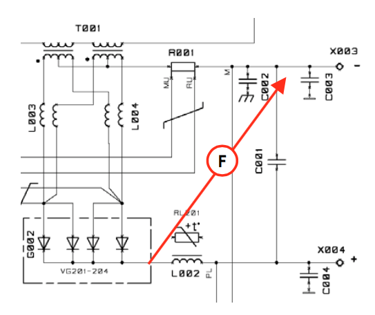

I am a marine electronics tech and half the time when we werent working on boats, we would be fixing migs, tigs and plasma cutters. I have my favourite welder here, the Kemppi 1500, but after cringingly using it on full power off a 8kw diesel generator (the cleanest I could think of for remote power) after 3 mins of welding, it bogged the gererator down and I knew it couldnt be good. Dismantled and found one of the four output doides shorted. They are too old to really see the part number on them but there appears to be two different numbers which I couldnt understand. Hopefully they were just doing the same job but maybe a different time of manif. Anyway the above service book I couldnt find actual PCB layout/discriptions, and the closest I found was the screenshot attached. Can anyone help be figure out what Diodes to use? the numbering I can see looks like- (6?)750144 9620. another one that wasnt faulty that i pulled to check the # on is almost impossible to read but here goes- (9?)7(6?)(3?)144 ???1 Id love to get this unit going, its a great machine and a few diodes wont be the death of it!! Thanks

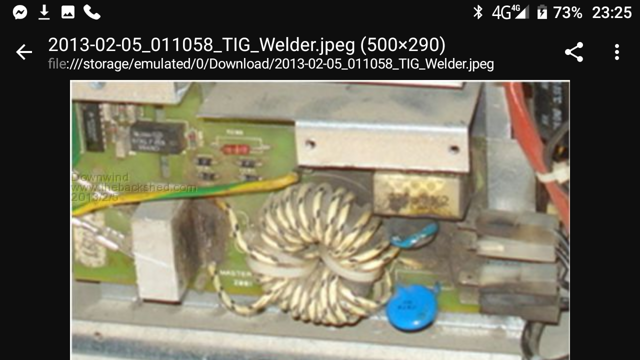

Hello , can anyone help me with the power filter board schema ? I lost the PCB before repair it.. . Thank you. I found picture on the internet.
Flyingkiwi1 and Dex0906 -
The attached PDF includes the major parts list and a schematic for the Kemppi Master 1500 (except board A001). Most of the boards in the MasterTIG should be the same. I think.
The schematic is at the end of the attached parts list. Unfortunately, in all their Finnish wisdom, Kemppi give part numbers rather than values. But perhaps it will help. The schematic came from, I think, Rapid Welding in the UK (www.rapidwelding.com) who have a great document library. You could ask them for values...
Good luck,
Walter.
