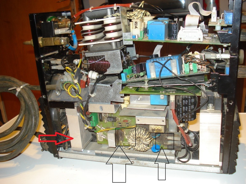

Hi,all members this forum.
In last weekends I bought in the ,,FLEAT MARKET,,one Keamppi 1500 master. The seller said ,,IT is faulty but sure can be repaired,,
I disassemble all ,,KEMMPI ,, for to clean.
The first time i saw that pcb Z001 -FILTER POWER -it is faulty.
The resistors RZ101 and RZ102 burned all because(in my opinion) primary power > 230V /50Hz sure ,,Diesel electrical generator,, was defective.
Now not understand -RZ 103 why burned ?
ok RZ 103 -through the voltage 220 V ac -to diodes bridge- to optocupleor type CNY 65 -
I rebuilt the circuit add RZ 103 --35KΩ ????? I removed CNY 65 and chek voltage in point diodes optocupleor --3,5 V dc. I mounted the diode I check current and i see 1,5 mA dc .
I energized electrical 12Vdc the circuit MC 14093PBC point 7 gnd 14 + and check signal in point 1 -conector .
Here not exist signal .
Where i wrong or who is cause ?

The first pictures tilling location filter.
Uploaded with ImageShack.us
The second pictures tilling all filtter disassemble.

Hi Ioanas,
I can see so far you've done most of the hard work.
First of all, all of the named "RZ" components are not resistors,
they are varistors ..... these will burn up exactly as shown once their rated voltage value has been exceeded .....ie. they act as open circuit (high impedance) when a voltage below their rated value is present, BUT, when this rated voltage is exceeded, they immediately switch to a very low impedance (basically a short circuit) therefore causing the inline protection fuse to blow. Hopefully you still have
the faulty items (or bits and pieces from them) as you will then be able to identify the proper replacement value from them.
Onto the circuit operation..........you can setup and test this board outside of the machine.
I would suggest you get an oscilloscope for checking these waveforms
(BUT MAKE SURE that you use a mains power isolation transformer on the oscilloscope mains power input) before performing tests on mains side of the this circuit. ......VERY, VERY IMPORTANT!!!!!!!!! ..... otherwise you WILL destroy the oscilloscope due to its input side being connected to earth AND possibly electrocute yourself in the process!!!!!!!!!!!!!!
From 220V 50Hz line in, this is full wave rectified, so you should have 100Hz pulses onto the anode of your diode side of the optocoupler. IF not replace the bridge rectifier .... all 4 diodes, as
they have sustained a heavy hit from the overvoltage input.
With 12v setup as you have shown in your circuit, you should see these pulses appear at the collector pin of the optocoupler and also at pin 8 and 9 of the schmitt trigger ic..... if not, replace the
optocoupler, or check that the capacitor across the optocoupler is not short circuit, or that the feed resistor from 12volt to pin 8 and 9 of the schmitt trigger ic is not open circuit, or that the input pins 8 and 9 of the schmitt trigger ic are not short circuit.
The schmitt ic is used to convert a jagged input waveform on pins 8 and 9 into a nice squarewave on pin 10.
Pin 4 of output plug A I notice, (when you have your circuit board out of the machine), has been left floating..... you should place a temporary 10k resistor between pin 4 of plug A and ground so as to load the output and be able to to see this square waveform. You are not getting an output because either the schmitt ic is faulty, or because its output is not loaded .... also check that the resistor from pin 10 is not open circuit, or the capacitor after this resistor is not short circuit.
All (on this pcb!) should work after this......hopefully.
