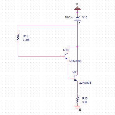

Problem with darlington circuit
Hi MikeMl,

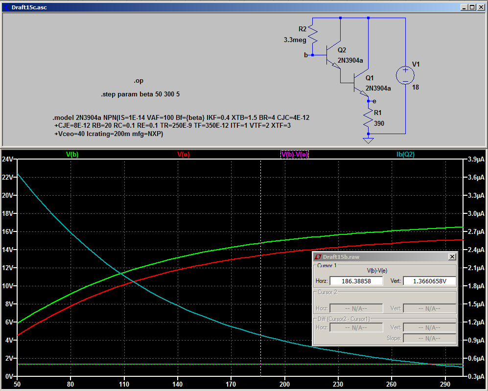

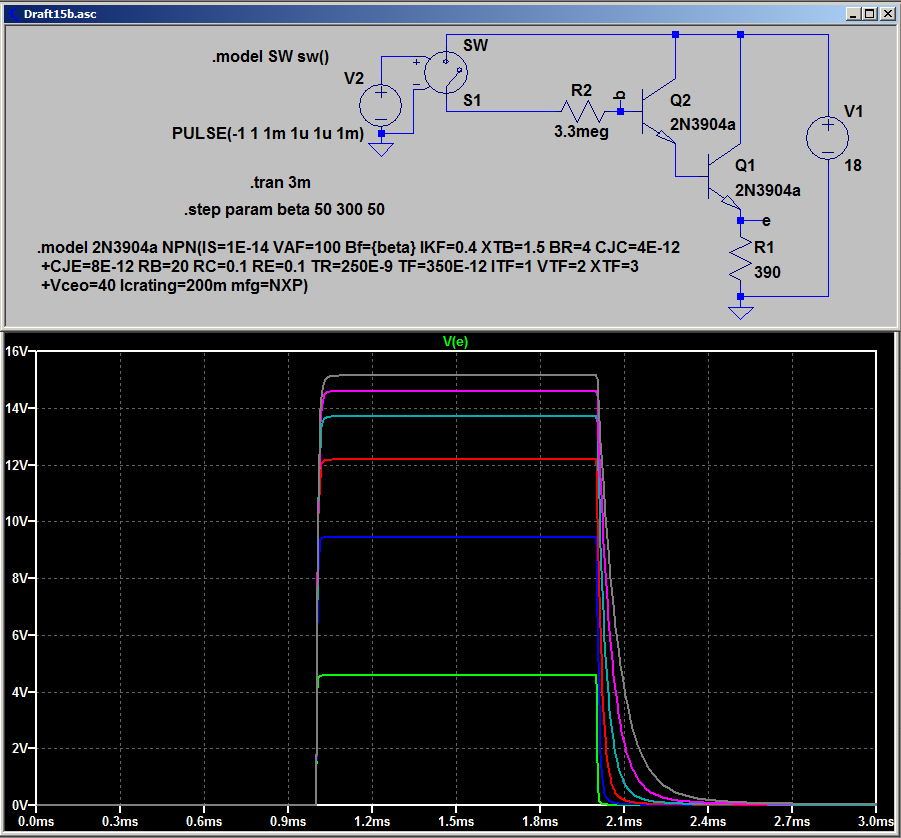

I agree that with a real transistor an iterative solution would be required. The value for the hfe of the transistors quoted by the OP (443.3) is higher than the maximum value of 300 shown on the data sheet that I have. Also the value of hfe varies with the collector current so the method I used would not work with a real transistor. I don't see the point of this exercise as the result is so dependent on the hfe value which has quite a wide spread for any particular type of transistor.

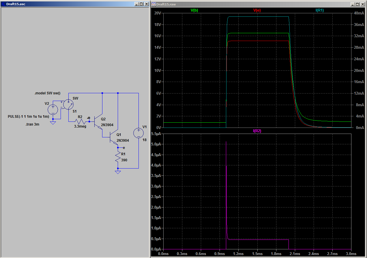

This one is specifically for aliraza54 :
Everything you wanted to know or were afraid to ask when β=443.3:
Note that Ib(Q2) is only 0.22uA, much less than you thought...

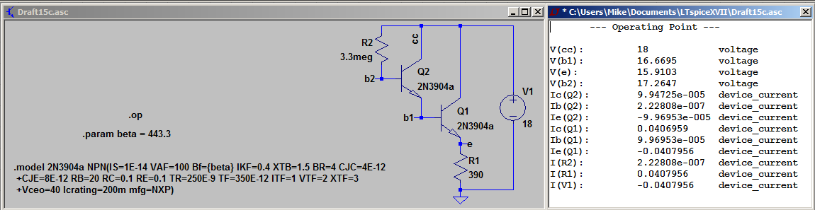

Try this: (using the reference designators as in post#22)
Ib2 = (18 -Vb2)/R2 = (18-Vb2)/3.3e6 (1)
Ic2 = β2*Ib2 (2)
Ie2 = Ib2+Ic2 (3)
Ib1 = Ie2 = Ib2 + β2*Ib2 = (1+β2)*Ib2 (4)
Ic1 = β1*Ib1 (5)
Ie1 = Ib1 + Ic1 = Ib1 + β1*Ib1 = (1+β1)*Ib1 (6)
Ve = Ie1*R1 = 390*(1+β1)*Ib1 = 390*(1+β1)*(1+β2)*Ib2 = 390*(1+β1)*(1+β2)*(18-Vb2)/3.3e6 = 390*(1+β1+β2+β1*β2)*(18-Vb2)/3.3e6 (7)
Equ 7 is the first of two equations in two unknowns. The second is:
Vb2 = Ve + 0.65 +0.65 = Ve + 1.3 (8) (I prefer Vbe=0.65V for Si transistors)
Substituting 8 into 7 gets:
Ve= 390*(1+β1+β2+β1*β2)*(18-(Ve + 1.3))/3.3e6 (10)
Suppose β1 = β2 = 443
Ve = 390*(1+443+443+443^2)*(18-(Ve + 1.3))/3.3e6
Ve = 1.181e-4*197136*(16.7-Ve)
Ve = 388.8 - 23.28*Ve
Ve = 388.8/24.28 = 16.01
Which, if you look back at post #22, is very close to what LTSpice predicted... (See V(e) = 15.9103V)
ps. I believe LTSpice more because it knows what Vbe2 and Vbe1 really are instead of our rule-of-thumb guess of 0.65V

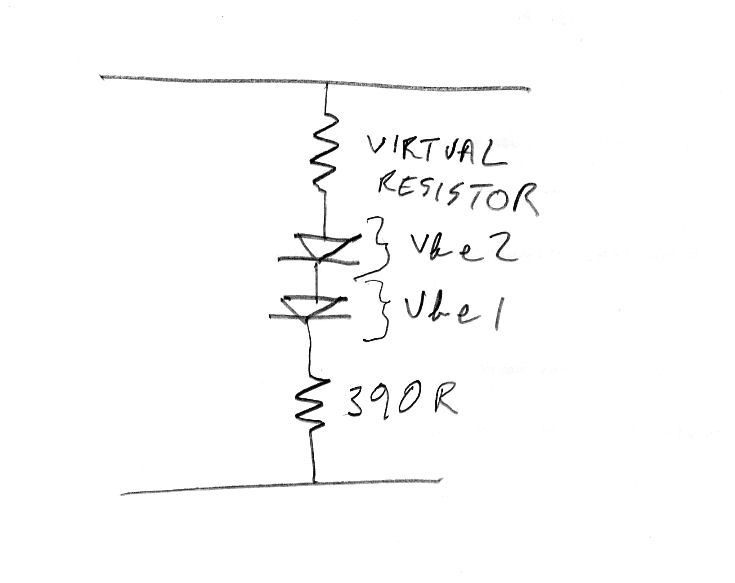

Hi spec,
I can see no fault in MikeMl's equations. I realise now there was a mistake in my reasoning for my virtual resitor method. It's value should have been R2/(1+β1)*(1+β2) Not R2/(β1*β2) as I had based my calculation on.
This is the equivalent circuit that my method is based on.
Using the values in the above calculation Rv = 3300000/444 *444 = 3300000/197136 = 16.74 ohms. Using the vbe values of 0.65 volts we have 18 - 1.3 volts = 16.7 volts so the current through the resistors is 16.7/(390 +16.74)
= 16.7/406.74 = 41 mA so the voltage across the 390 ohm resistor is 15.99
Les.
