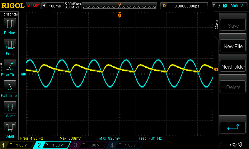

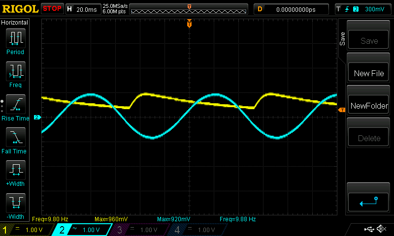

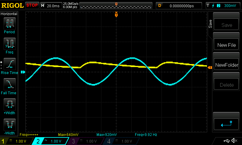

Problem with chained LM3915

Your frequency is extremely low at 8.69Hz so your 'scope shows the peak detector output voltage ramping down between half-wave pulses.
Try removing Q3 and/or R14 to remove the Automatic Gain Control compression. The AGC allows a signal 10 times higher to activate the same LEDs as the lower level.
Do not exceed a peak input voltage of 2.1V which is only 0.276W RMS in an 8 ohm speaker. The value of R9 must be increased to allow higher input levels.

but, i tried changing r9 from 50k to 100k and output from peak detector drops so it doesn't show peak anymore, even at new cutoff which is half from earlier
all shots have Q3 removed
r9=50k (9.8hz)
r9=100k (9.8hz)
r9=100k (4.8hz)
and even at audible frequencies like 60hz or so peak doesn't rise in r9=100k situation
