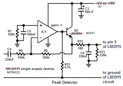

I was wondering, is it possible to change that your circuit so it shows average instead of peak? as i'm planning to place both peak/average, if that is easily made instead of peak/instant. Or then only peak, just thinking out loud here
Increasing the Value of the .33 cap on the Output should do it. (A 1 uF or 4.7 uF.)
i was thinking about similiar, as bigger capacity capacitor holds charge longer. If i'm not terribly mistaken it also charges slower but that's negligible in this situation, it's still avergae
The datasheet says that feeding the audio directly to the input of the LM3915 without a rectifying peak detector and without a capacitor will allow some peaks to be seen dimly and average levels to be brighter when the LM3915 is in the DOT mode.
A true average detector charges its capacitor slowly and discharges it the same. Then the datasheet shows changing the 100 ohm resistor to 100k ohms, and the transistor is not needed. You will not see the peak levels that might be much higher than the average levels. If you increase the capacitor value then the discharge will be too slow causing many events not to show.
That 100 Ohm Resistor will Not Slow down the Charge rate very much.
The low value of the 100 ohm resistor charges the peak detecting capacitor very quickly but limits the charging current. I said the datasheet says to change it to 100k ohms to see average levels then it charges slowly the same as it discharges.

Are you configuring a peak detector diode as an ideal diode with the opamp? It should have enough drive (20mA) to 'fill' the capacitor in time. I= C dv/dt is the eq you can use to calc. that response capability.
https://en.wikipedia.org/wiki/Precision_rectifier

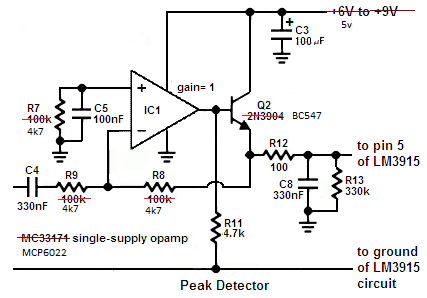

The peak detector is a precision type with an output peak voltage within a few millivolts of the input peak voltage. Your last posted schematic 2 weeks ago and mine should work perfectly so please post the schematic that causes the 0.4V voltage drop.
Why are your resistors R7, R8 and R9 only 4.7k when mine are 100k? Then the cutoff frequency of C4 and R9 is 103Hz so it will not detect bass frequencies.
I opted that 103hz would be good for my purposes, at least it seemed to give best performance so far, but that can be false performance if this circuit is not working as intended, yet i mean
circuit for 103hz

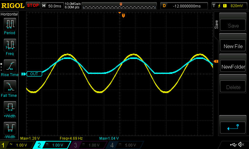

scope shot, actually voltage drop was much lower....0.2 volts

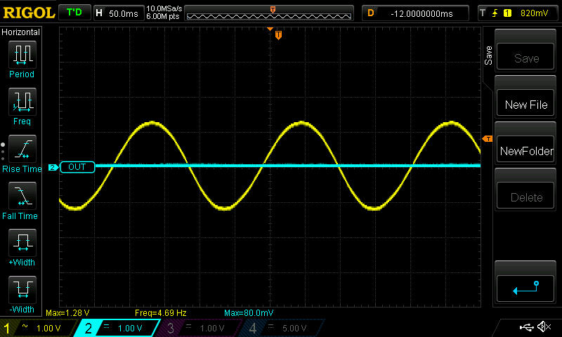

and for comparison, original values of 100k resistors (4.8hz)
and there's some bumbs at output too
tested with 3 different NPN small signal transistors: bc547, 2n5551 and c1815, same results

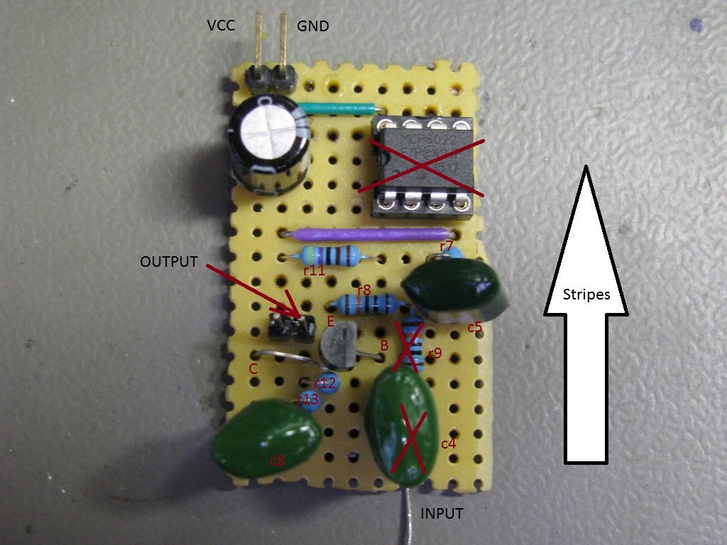

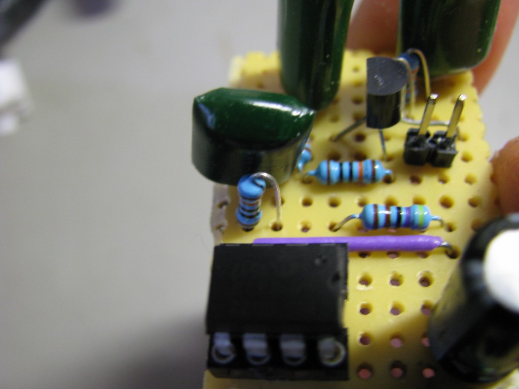

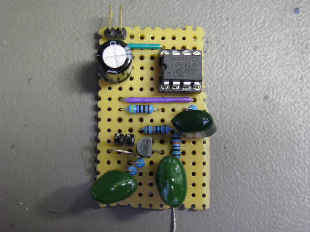

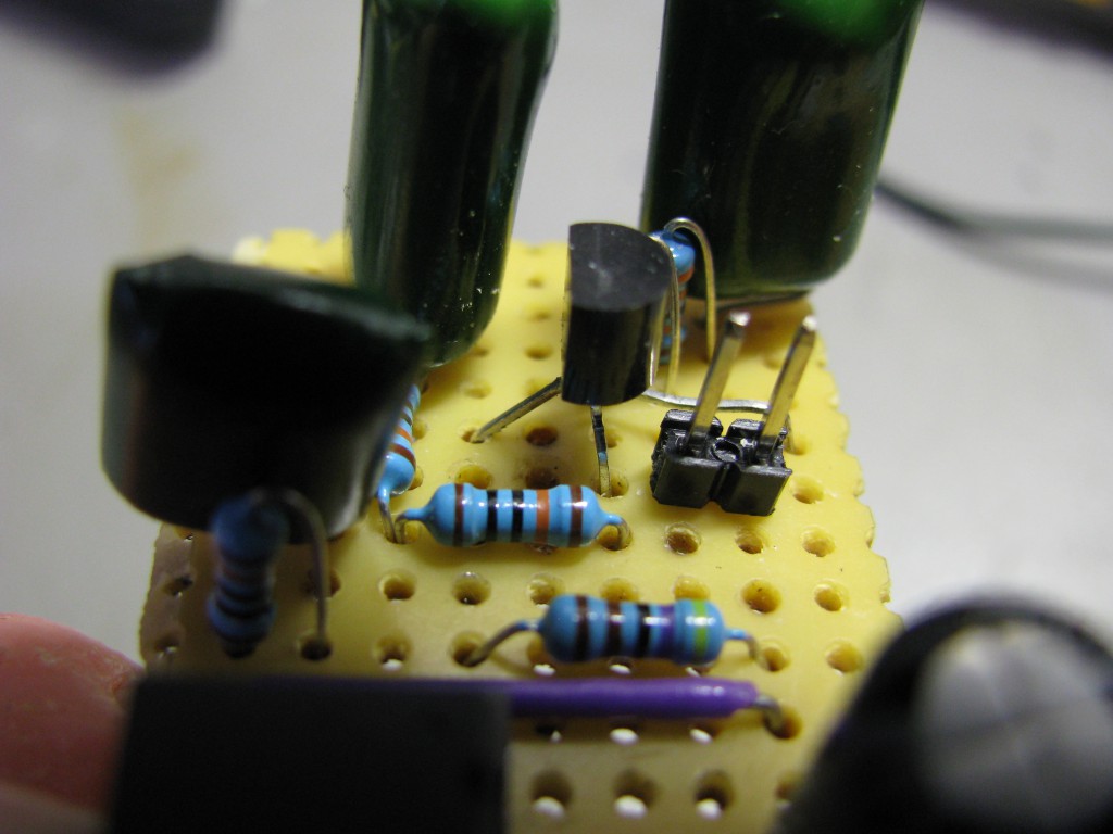

here's couple shots from protoboard

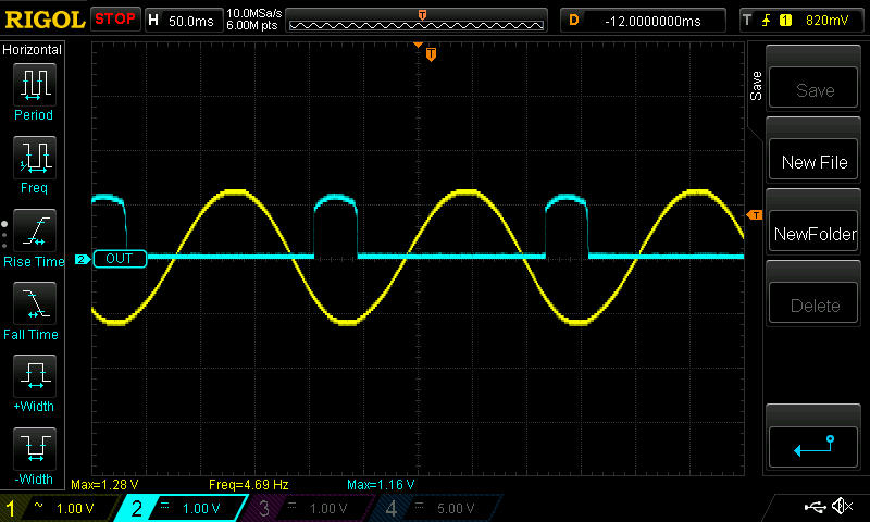

output from opamp

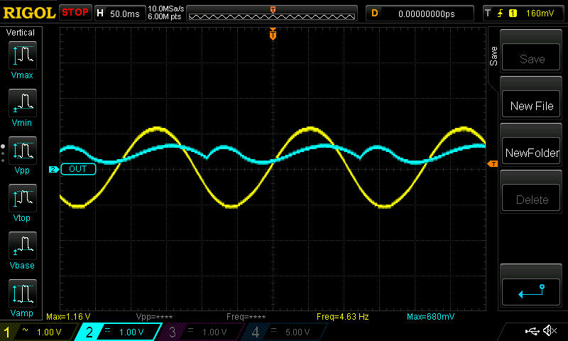

inverting (-) input
non-inverting (+) input
The OPA FB pulling down your input sig it seems.
Use another OPA to buffer the input signal first or increase the input cap by about 10 times.
Also R11 may not be required as that OPA does not have crossover distortions.
Try the precision rectifier circuit from wiki...the input signal is isolated from the FB, none of these design complications that you have.
