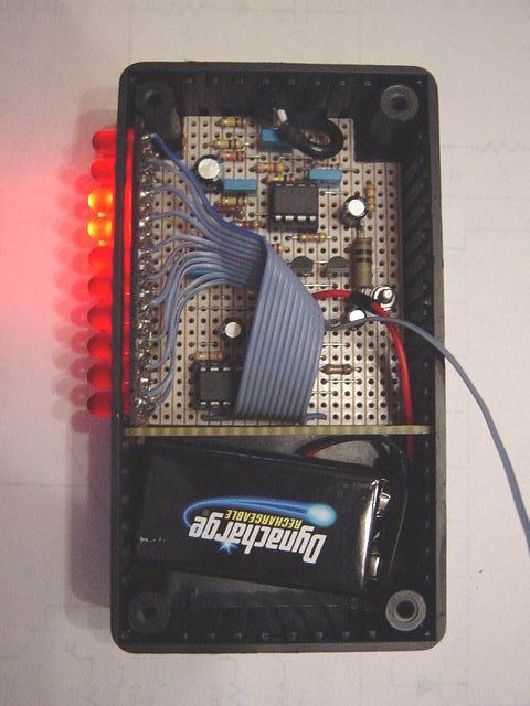

My "VU bar graph" does not connect to my amplifier because its input is a microphone. It displays the loudness of the TV, the stereo and talking. It has been displaying continuously for 10 years.
I added some parts to trick the LM3915 into two bands of levels, very sensitive and fairly loud. Then instead of 30dB with one LM3915 its range is 50dB. Here is its schematic:

is that veroboard in that enclosure double sided? nice build & schematic!
i do understand that peak-detector section somewhat, but, what function is with those q1 & q3? and i suppose for mic-amp section, non-inverting output has dc-offset made with those 100k & 47k resistors. C1 is at lest so dc won't go from power rails to that non-inverting output yes?
Just trying understand topology in that circuit, i see less point using circuit unless knowing what's happening there...
Thanks. It is a copy of single-sided Veroboard made in China. The copper strips form half of a pcb and the parts and a few short jumper wires form the other half.
understand that peak-detector section somewhat, but, what function is with those Q1 & Q3?
Opamp IC1b has a low output current so it drives Q2 that can apply a lot of current to quickly charge peak holding capacitor C8 but allow R13 to discharge it slower. Q1 has the same Vbe voltage drop as Q2 and applies negative feedback to the opamp. Q3 quickly charges capacitor C9 then it discharges very slowly (about 2.5 seconds) into the resistor ladder in the LM3915. The voltage on C9 feeds Rhi of the resistor ladder but resistor R15 biases C9 at about 0.56V when sound levels are low so the circuit is very sensitive. Loud sounds cause Q3 to charge C9 to 10 times the 0.56V idle voltage that reduces the sensitivity 20dB.
Suppose for mic-amp section, non-inverting output has dc-offset made with those 100k & 47k resistors. C1 is at lest so dc won't go from power rails to that non-inverting output yes?
IC1a is a standard opamp biased at half the supply voltage. The two 100k resistors in series from +5V to ground make 2.5V. The 2.5V is fed through the 47k resistor R4 to the (+) input of the opamp so that its input and output can swing up and down.
C1 blocks the DC voltage that powers the electret mic from affecting the 2.5VDC at the input of the opamp.
Usually I put a capacitor to ground where the two 100k resistors join but not in this circuit so the 47k resistor is not needed.
