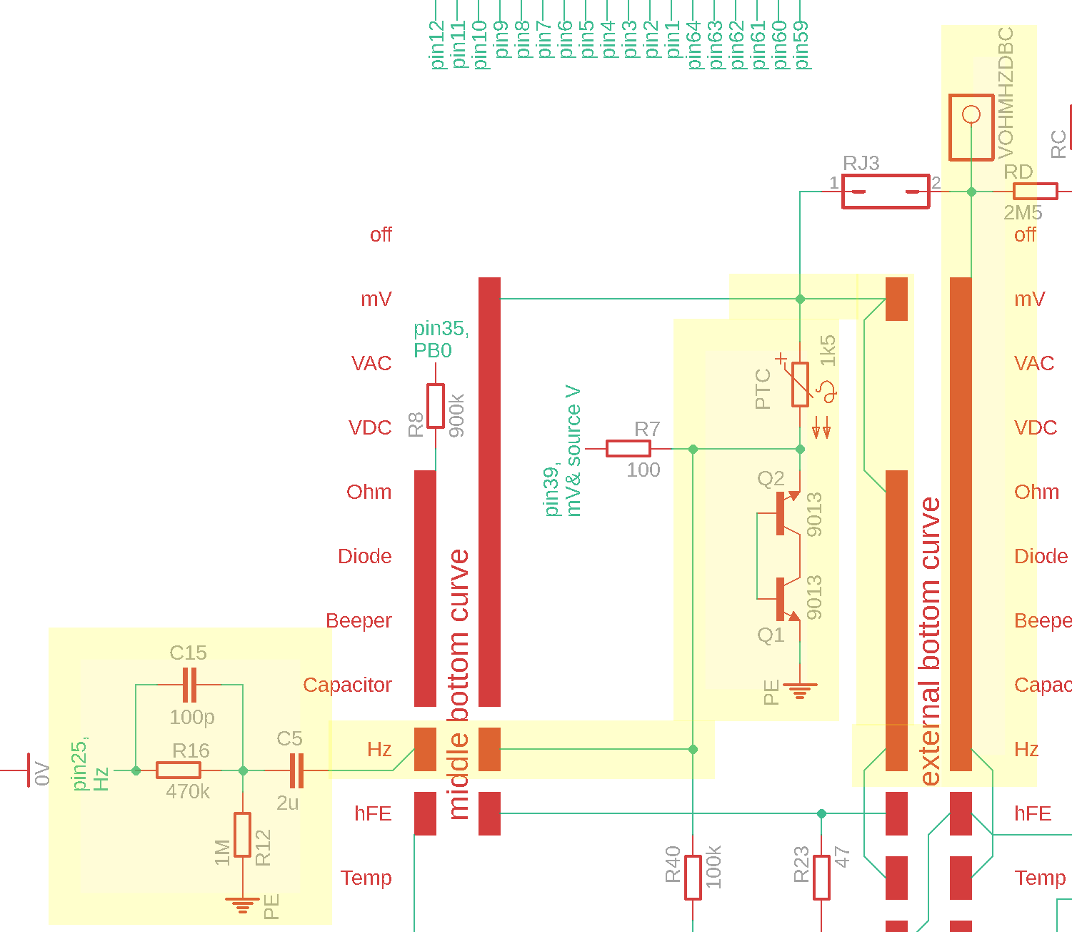

I have a vc97 multimeter whose frequency meter does not work, what should I do? I used the power transistor of the hot part to measure the peak city electricity. I wanted to measure the switching frequency from the transistor, but the device had a problem in the frequency meter part.
Where is the frequency meter circuit of the vc97 multimeter and how does it measure the frequency, there was a schematic on Google, I didn't understand

It's a different version of the meter PCB to the one in that schematic; that looks to be for this version:
Note the OPs photo shows a 64 pin IC, DM1106. That, from what I can find is a newer alternative to a DTM0660, which does have quite a bit of info available - eg. IC datasheet:
There is a VC97 multimeter schematic in this article which may be a bit closer, as it uses the 64 pin IC, although the earlier 0660 version?
The only components dedicated to frequency measurement are close to the centre of that, connecting through the PTC and clamp? to a coupling cap and an RC network, then IC pin 25.

This is the relevant part of the circuit, from the normal input socket to pin 25 (frequency counter) on the IC.
It does connect through via the Q1 + Q2 clamp circuit which should limit it to probably something like +/- 6 - 8 V, and the transistor are rated at 500mA, so it should stand 750V peak at the input, as far as the clamp and beyond that are concerned.
With only 1500 Ohms series feed to that, the initial dissipation through that PTC thermistor will be quite high at 240V AC - around 35W instantaneous, which may have blown it before it had time to heat up and it's resistance increase sufficiently to protect itself??
It's definitely not suitable for measuring frequency on high voltage sources.
Does it still work correctly on the millivolt range? It may be that is the only other one that would be affected by the thermistor failing?
q1 and q2 and ptc
are healthy and the path of pin 25 ends with the selector
