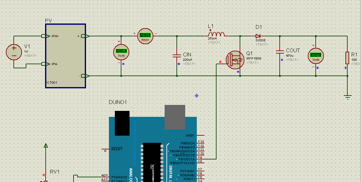

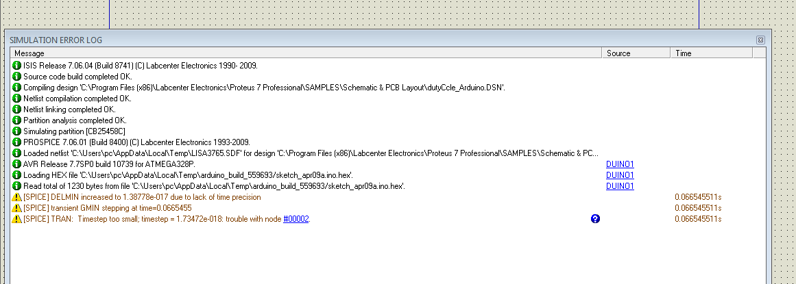

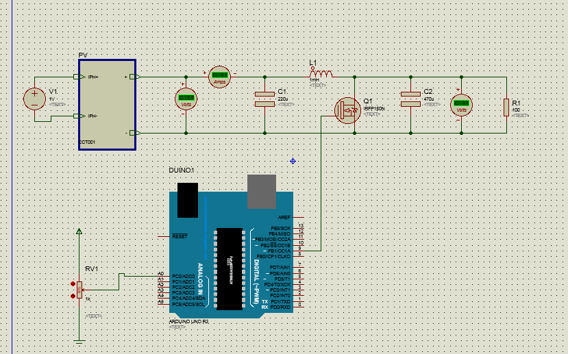

hello, please I have another problem but now when I want to control my Boost converter.
when i play my simulation i got this Error.

Your circuit is missing an important diode that keeps the capacitor from being discharged by the Mosfet. Look in Google.
Thank you to replying my question, Actually, I missed two things the diode and the Ground.
now added them, but the result is strange.

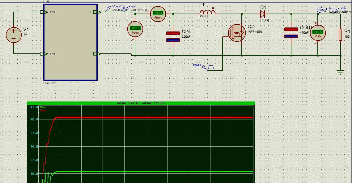

thank you for replying me, the PV is my input tension, like you can see in this screenshot when i use just a PWM generator for (dutycycle=50%) the result is like I want, but when I use Arduino to control my MOSFET there is a problem.
