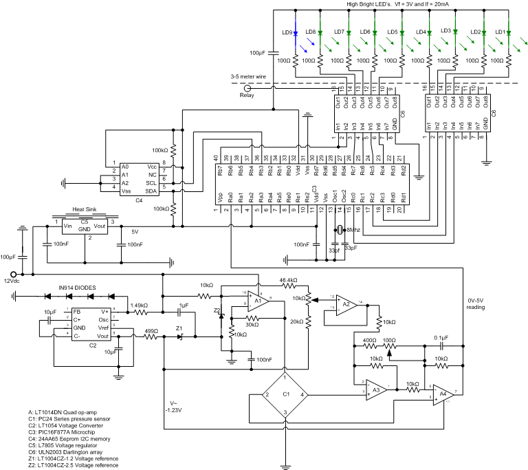

Added a 7805 Vreg to your circuit, also some decoupling caps.:)
The heat sink on the 7805 may not be required, depends upon the current load of your project.
EDIT: the 20mA current per LED calculation needs checking,, I = [Vpin-Vled]/Rs .

I have updated the circuit with all your replies.
I have included the 7805 like you described and I also placed in 2 ULN2003 components to drive the LED's. Did my calculations based on a 5V supply to the LED's. If it was a 12V supply then the Resistor value would be 450:eek:hm:.
I've also thrown another spanner in the works as I forgot to mention that the LED's will be about 4-5 meters away from the components. I have therefore placed a capacitor on the 5V supply. Is this all I need to do? For long distances does it matter whether 5V or 12V are transmitted on the wires?

Morning Rich,
Check the voltage supply to the anodes of the LED's, where is it.??
Whats the [LED] 100uF going to do, wired in that way..:)
I thought that...I just saw it on a diagram somewhere during my searches. If I place it in parallel will that take care of the long wire?
Look at the modified drawing.
