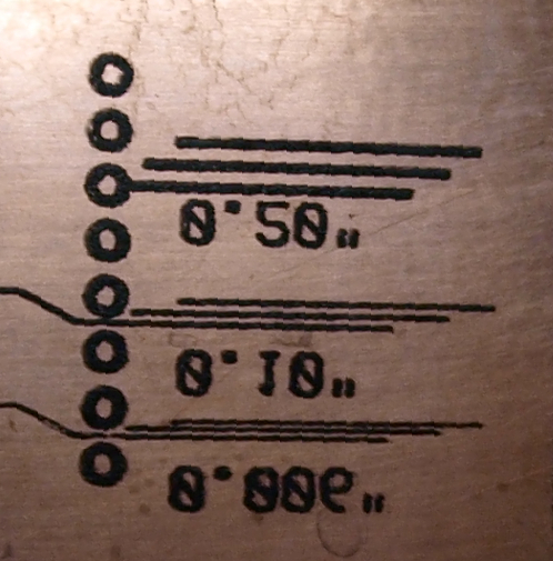

But here is my first try (before etching):
The lines are 0.20", 0.10" and 0.06"
The photo looks promising for small tacks even, but how come that the tracks are see ripped, as if not horizontal. Perhaps track edge registration has to be proper.

The photo was not rotated to the exact horizontal position of the lines.
Granted the 0.06" traces are not perfect.
The spray starch can I used was almost empty and it was not much of a spray, more like spurts.
So I cheated a little and rubbed it around with my finger.
I am sure the starch is in a water based solution so there should be no problems.

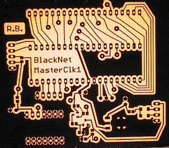

Rolf why don't you try pressnpeel? Especially with a laminator it will do a much cleaner job than what you got with the toner and starch.
This was done with pressnpeel blue and a few passes through the laminator, it doesnt show that well in the pic but the .010" tracks are razor sharp. And you can leave the pnp on the tracks so they dont corrode.
