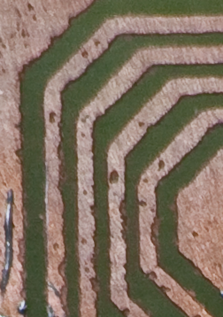

The issues I've had with AP is the length of time it takes. I'm guessing that might be directly related to the second issue I have with it, which it does not give me crisp edges to the etched lines. I get a bit of pock marked edging. It's still very useable, but doesn't create nice edged lines like I'm used to.
This one was etched with AP. If you want to see the detail of the edging I'm talking about, I can break out the macro lens and show you the traces.

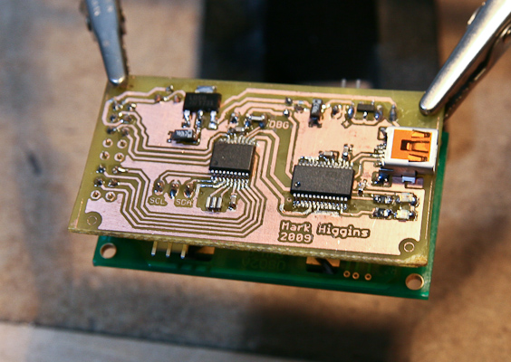

I would consider this a regular FC board that I make:
I took a picture of the etching issue I'm having with ammonium pursulphate. You can see the pock marking I'm getting.
full board and trace close up attached.
I see what you mean. I would be unhappy too.
Is you AP etchan warm enough ?
Some time when I am etching a few of the same design I will run some with SP and some FE and see if I can tell which is which.
As SP gets older/weaker it takes longer to etch. It seems that this leads to more pinholes but it could be that I am getting the etchant too hot. I need to build a etching tank with heat control to be sure. Of late I have been heating it in the microwave.
Great job Mark!
