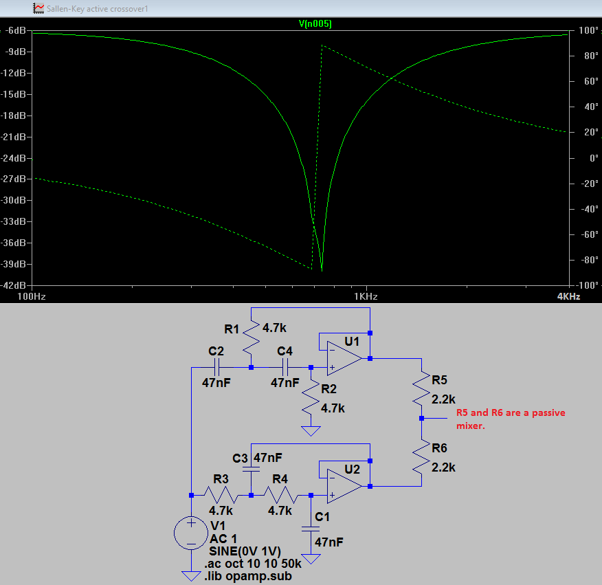

A crossover that is 12dB per octave has 180 degrees phase shift at the crossover frequency if the highs and lows are in phase so they cancel causing a notch. If one set of speakers has its phase reversed then they add +3db at the crossover frequency. A Linkwitz-Riley alignment prevents the +3dB.
A 3rd-order crossover is 18dB per octave and does not cancel or add.
The Soundstorm SSLSX310 is 12dB per octave and its spec's say only its length and width, nothing about its alignment or if it avoids cancelling or adding at the crossover frequency. They do not know anything about specifications for sound products.
Here is a simulation of a 12dB per octave active crossover with a Butterworth alignment and the highs and lows in phase showing the notch (solid line)and the phase shifts (dotted line). They are mixed with a passive mixer which causes the -6dB at extreme frequencies.
