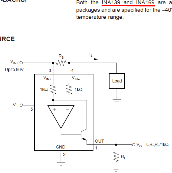

hi all,im after using an op amp as a current sense amp on a psu,30v max output,the op amps i have are jrc4558 ic's,the max supply voltage is 18v,i wanted to use them from the same power rail as the psu,obviously i cant do that,now the question is can i power it from say a lm 7824 reg?,the differential voltage is 30v max,can the voltage at the current sense resistor be higher than the op amp supply voltage?hope that makes sense,cheers m3vuv.
There ar special amplifiers for high side current sense which the voltage can exceed the op amp supply voltage. See analog Devices.
You can also look at hall effect sensors from alegro which will provide isolation and use a 5V supply.

The two R1s are the same value, the two R2s the same value. The ratio between R1 and R2 sets the gain. With suitable resistor values the inputs can be far outside the supply; only the r1:r2 junctions need to stay within the opamp common mode range.

Max 4558 power is +/-18 V, or 36 V total. However, the input common mode voltage range does not include the positive rail. While you can power the opamp directly from the +30 V and GND, you cannot use its inputs to sense the voltage across a shunt in the +30 V line without a circuit trick. Also, the output cannot swing very close to the negative rail, so low values of sensed current will not produce the correct output voltage.
Overall:
Yes, the part can be made to work in your circuit.
No, it won't work very well.

Even simpler for high-side current sensing are parts like the ZXCT1009
Over-voltage concerns can be addressed by adding a resistor ladder to activate a fixed voltage regulator that supplies the IC, much like a power transistor can supply extra current beyond the IC's rated limit. If you examine "power supply limiter circuits" online, you'll find several methods of excess voltage controls.
