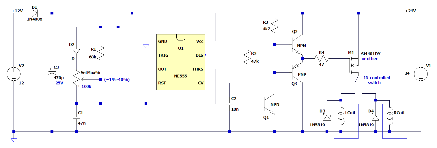

Powering a PWM valve with 24V PWM
Well well well. You are certainly being a great help. Problem is at the moment I can't answer all your questions but will certainly endeavour to get all the info.
I know the Jd has unlimited movement
I believe they are switched highside
Wattage and resistance unknown ATM
I believe it's just the PWM SIGNAL
No idea about the dither.
MAX duty cycle is 30%
I believe both solenoid are in a dormant state when machine is going straight.
Frequency unknown at the moment.
I will attempt to find more information
Here's a first draft of the interim, fixed duty-cycle circuit.
It comes with no warranty :).
A standard '555 based oscillator generates about 270Hz and the pot allows adjustment of duty-cycle from ~1% to ~40%.
The coils are high-side driven in this circuit. The MOSFET shouldn't need a heat-sink and its type is not critical.
Wiring to the valve coils should probably be screened to avoid any interference with the CAT's ECM.
Depending on the 12V and 24V power supply characteristics and the dozer electrical system the circuit may need additional decoupling and transient suppression components.

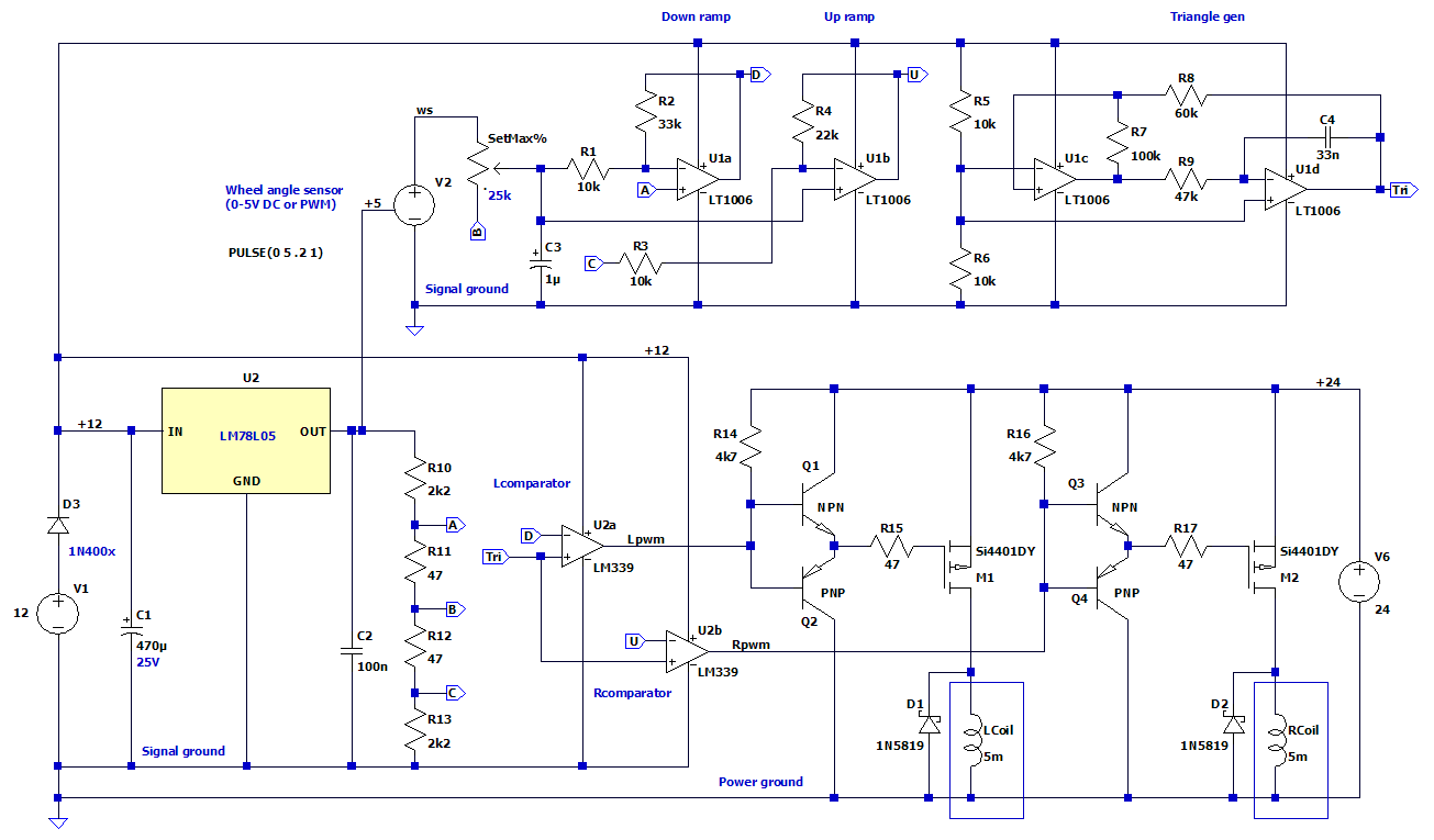

..... and here's a first draft of the fully-fledged PWM driver if you find you need to use a wheel angle sensor for proportional rather than bang-bang control. I have assumed the angle sensor is a Hall effect type operating on a 5V supply and providing either a 0V-5V analogue output or a 5v PWM (~ 1kHz) output. The same caveats as for the post #22 circuit apply.
U1a and U1b derive downward going and upward going ramp signals D, U respectively, according to how far the angle sensor output varies from its mid-point value. These signals are compared (by U2a, U2b) with a triangle wave signal produced by U1c and U1d to provide PWM signals Lpwm, Rpwm which drive push-pull stages Q1-Q4 and hence high-side P-MOSFETS M1,M2 to power the steering valve coils Lcoil, Rcoil. A pot provides scaling of the angle sensor signal and so allows adjustment of the maximum duty-cycle of the coil drive.
It would be advisable to test a prototype circuit in the lab so that component values can be tweaked prior to installation on the CAT.
