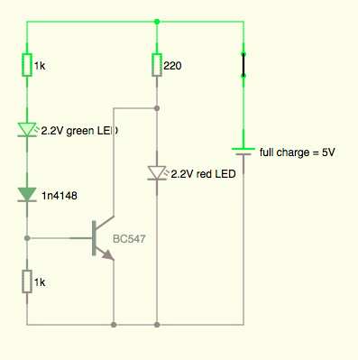

Hy. I am planing on doing a simple raspberry pi project. I will power the chip with a 5v powerbank. The problem is that the raspberry pi zero (or the powerbank itself) does not have any means of indicating if the battery has enough charge to power it. I don't want the battery just to cut out when it's empty I want to power down the pi safely.
I want to make a simple circuit that will light up an LED when the voltage of the battery gets to low. The raspberry pi needs at least 3.3 volts to run so if the led would light up at about 3.5 volts that would be awesome. But most circuits I found online are overcomplicated for what I need with multiple LEDs or connecting to the raspberry pi GPIOs that I find unnecessary (not to mention I have them all populated anyway).
So finally my question. Is there a simple circuit I can connect to a 5v battery that will light up an LED when the voltage drops to 3.5v? I am no electronics wiz... This project is basically how I want to learn some basics. So please be patient if I don't understand everything.

I was originally thinking of using something like this even if the green LED is on there. So if I use this before the power boost to 5v this should work? It's for 3.7v battery.

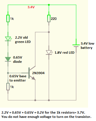

A 3.7V lithium battery is 3.2V when its is almost dead and its load should be disconnected and it is 4.2V when fully charged. Therefore its average discharging voltage is 3.7V.
Your simple circuit has many variables:
1) What battery voltage causes the powerbank to drop its output voltage or stop working?
2) Temperature changes the base-emitter voltage of the transistor and the forward voltage of the diode and the green LED.
3) Is the green LED a 2.2V dim old one or a 3.2V bright modern one?
4) Are the diode voltage and the base-emitter voltages 0.6V, 0.65V or 0.7V?
I don't think your simple circuit will work with such a low voltage anyway:

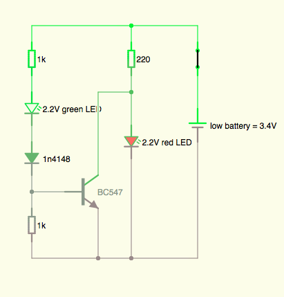

Well you got some components wrong. My bad for not writting them up. On my tests it works. I built the circuit with some parts laying arround (I used a different diode though). It's a bit messy because I didn't use a pcb. On the simulation it works. The actual build also works on a full battery. The green LED isn't fully lit but it's enough. I had no way of testing it if the charge isn't full be cause I don't have other power sources than the actuall battery and all other bateries I have have too low a voltage to even light up the red LED.
All I really need is the red one anyway. I'll try a solution with a comparator when I get one but I would still want to see what can be done with the circuit I posted.
Here are the simulations:
Screen Shot 2016-06-05 at 19.56.39.png Screen Shot 2016-06-05 at 19.58.40.png
