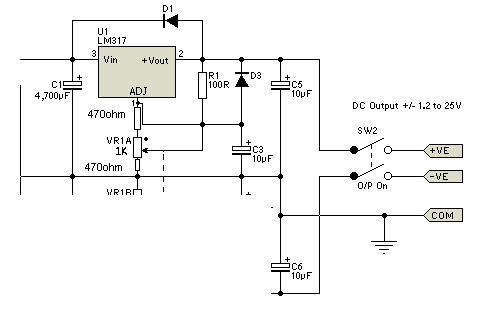

I tried this with the wall wart, which actually reads 17vdc.
With the board I get from 1.90v to 2.13v, with the 2.13v being when the control is set more or less central :? past central, it drops back to 1.98 or so.
Totally useless if nothing else :lol:
Are you sure you've wired the regulator the correct way round?, the article mentions that different manufacturers have different pinouts!.
Yep, Its in right. What i've done is breadboarded the below. It works fine apparently, giving 7-18v or so with linear control. I'm using an old scalectrix (sp?) power pack for testing, which is 23v, but sags very quickly and is actually rated for 12v when use with the cars. I've tried it with a fairly small load (220ohm), and only the regulator warms, but they will be on a heatsink anyhow. So, I think i'll be modifying the board to work like this, and will need to pick up a 1k dual gang.
Or, as the case may be, 2 single gang 1k's, as Maplin don't have dual 1k. At least there wouldn't be a problem with the voltages not balancing as I could adjust them independantly 8)

Hi Dr. EM,
Good, it works when you give it enough input voltage. :lol:
Your 470 ohm resistors limit its output voltage range. You can increase its max output voltage by decreasing the 100 ohms. With 68 ohms from the output to the reference, and a 1k pot to ground from the reference, the regulator's output voltage will be 19.6V, if the input voltage is 22V or more. Then the pot must dissipate 0.34W and be within a 0.5W rating. When the pot is turned down to zero ohms the output voltage will be 1.25V.
The linearity of the voltage adjustment depends on the linearity of the pot. :lol:
Yep, I prefer it with a 560k at the top of the pot and a 470k at the bottom, I want it so that the output voltage cant' exceed 18v (the maximum for most op-amps). That'll need to be tuned as the transformers voltage should be higher than 23v; 25v at least.
Alarmingly though, when I tried adding those transistors in to the breadboard version, I got different results to the stripboard one. I got the results that graph shows more or less, whereas the stripboard gives those really bizzarre results. It could be that the transistors have overheated in soldering (hopefully, as they are going anyway), that the regulators have overheated (they both behave exactly the same though) or that there is a problem with the type of pot i've used:
22k dual linear. Thats also not a big deal, as its going too, to be replaced with the 1ks. It would be annoying if it were the overheated regulators though, as they are in quite a specific location to accomodate the heatsinks, and desoldering is tricky :x . I've checked the board carefully for solder bridges, but I don't see any and the different voltage readings for parrallel strips confirms this.

Well, i've tried it with the resistor arrangement I posted on the stripboard version, and it does indeed work :D . Wierd thing is that the transistors and pot i've removed are all functional too. Must have just not worked together. Think I will increase the 100ohm to 150ohm, my new 1k pots are 0.2W :shock:
Hi Dr. EM,
Increasing the 100 ohm resistor to 150 ohms will increase the max output voltage of the regulator 50%.
The pots will operate at their max power rating with only 14.1V across them.
I thought it reduced it?
"You can increase its max output voltage by decreasing the 100 ohms. With 68 ohms from the output to the reference, and a 1k pot to ground from the reference, the regulator's output voltage will be 19.6V, if the input voltage is 22V or more"
I changed it to 150ohm, and can see that the output voltage has dropped quite a bit now. The output voltage will go over 14.1v, but I doubt i'll run it at the full 16 or so it does now much, the pots can probably take a bit of abuse anyhow :lol:
